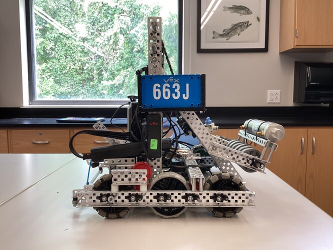

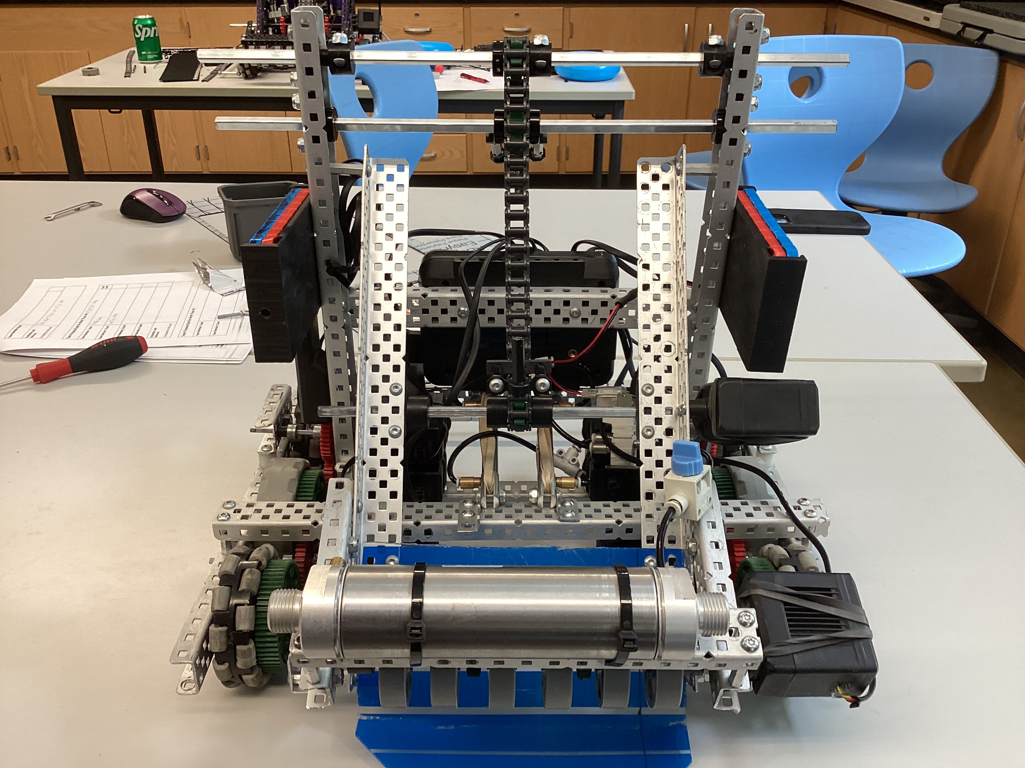

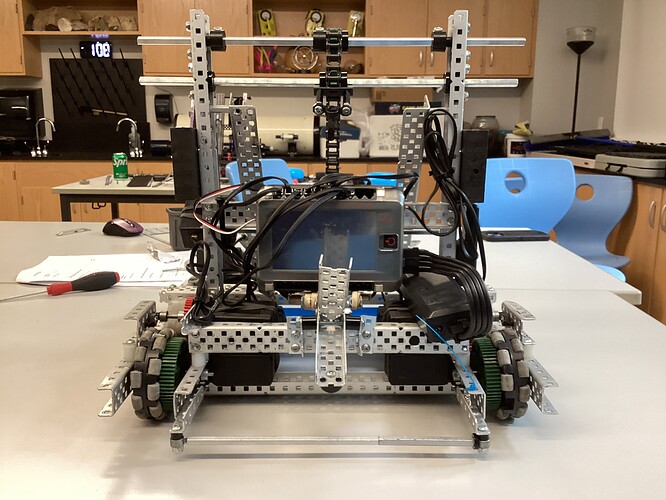

Specs:
360 RPM Drivetrian on 3.25 in wheels
2 Cylinder MoGo clamp
1 Motor floating flex wheel intake 600 RPM
1 Motor hook intake 600 RPM
(We know that the battery is not secure)
Built in 1 week
