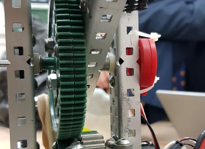

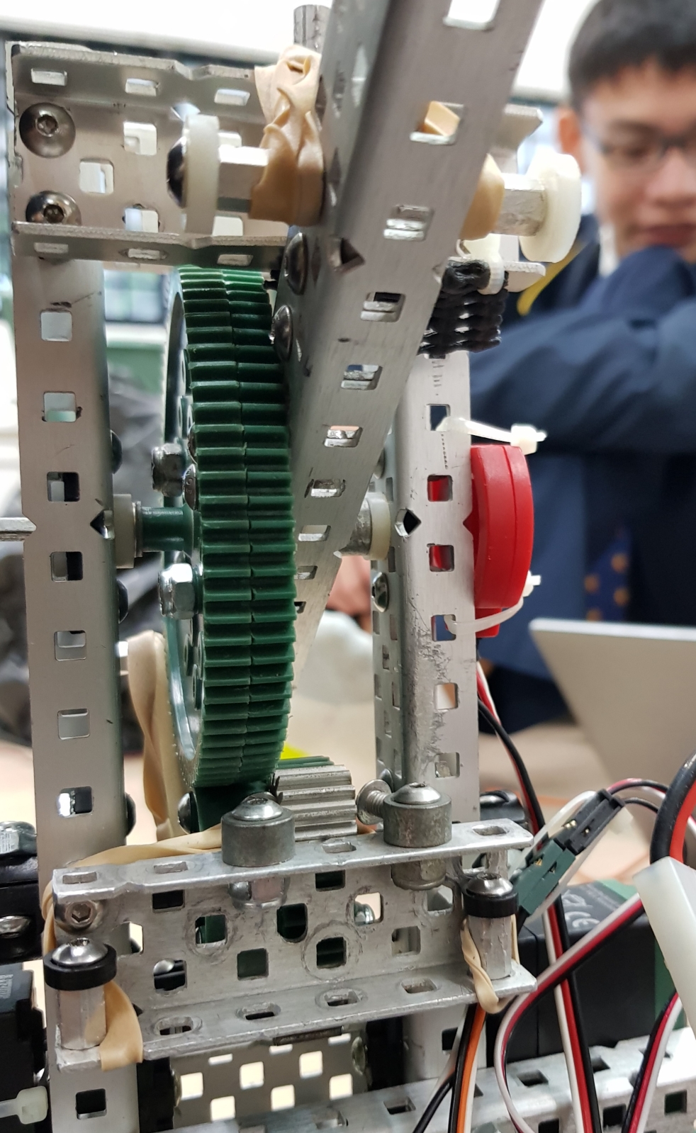

The VEX ratchet system was not used. However, to keep the catapult held downwards, a custom ratchet made out of a pinion with rubber bands was created. By using a rubber band to hold the gear down, it provides the ability to turn in one direction as the rubber band stretches. However, in the other direction, the gear is forced against a metal piece, stopping the catapult.
Robot is partially dismantled but… here’s a picture of the system in case there’s some confusion!
http://i67.tinypic.com/rs8rqv.jpg

So, when it turns the other direction, the 12T gear get stopped by the metal? Am I understanding?
You are right , the immobilisation of this pinion stops the entire catapult from moving . It’s also visible in the picture. It was built in a hurry so it does sound sketchy and might not be the best implementation but it worked well enough during the competition:)
What gear ratio did you guys use for your catapult? and what gear in the ratio did you implement the pinion? I can’t quite tell from the picture.

I am still super confused about the double catapult’s ratcheting system, could someone explain?
I specifically don’t understand how does the catapult stay back when down, but still has the ability to shoot forward ( doesn’t a ratchet prohibit movement in one direction).
The ratchet is on the slipgear so the slipgear can only rotate in one direction, thus holding down the catapult until its release point. Thus the catapult can shoot.
I’m also trying to build a ratchet but can’t seem to figure out how the rubber band let’s it spin one way but not the other. I was thinking of using one of those gravity ones, if y’all know what I mean
As you can see in this picture, the ratchet gear is different from a regular gear. The tooth on the top right corner will have a rubber band on its tooth on the right, pulling down, so that it forces the the lever towards the gear. Thus, when the gear turns clockwise, the lever skips the teeth on the gear but comes back every time because of the rubber tension. however, if the gear tries to spin anti-clockwise, it cant do it because the lever locks and it stops the tooth on the gear that it is currently contacting. So, the lever would be attached to the tower or something and the slipgear would be on the same axle as the ratchet gear so that it can only spin in the direction that will cause the lever to skip, and when unpowered, it would hold its position and not snap the catapult back so you can make it stop for loading.
