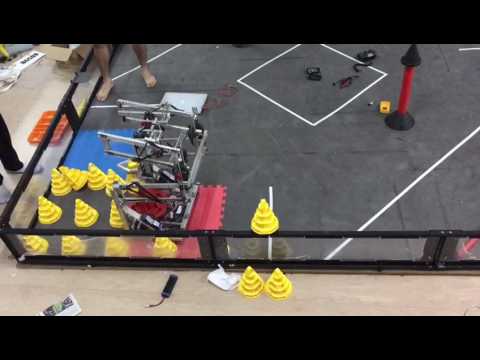

This robot was constructed over the span of three days, drawing heavy inspiration from a prototype (8059D).
Base:
6 motor rear wheel drive (speed gearing), direct drive on 4’’ wheels
Lift:
2 motor ( high torque ) RD4B, geared 1:7
Three-point latex system
Possibly unnecessarily tall? (7 by 7 brackets)
Together with chain bar, has the ability to score 12 cones on stationary and 18 on mobile goal
Cone intake system:
1 motor chain bar, geared 1:3
1 motor claw, geared 1:1
Chain bar swivels either downwards or upwards 90 degrees, reducing total motion of chain bar
Mobile goal intake system:
2 motor linear slide mechanism, geared 1:1 using strength motors
Reliably scores in 20 and 10 point zone (chain bar guards stack for stacks more than 6 cones high)
Autonomous: 9 points, excluding the highest stack bonus (1 mobile goal and 2 cones in 5 point zone)
Programming skills: 32 points

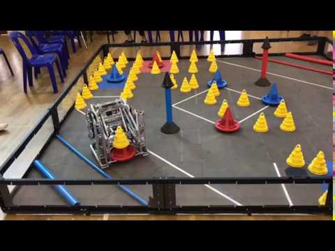

Specifications:
Base:
10 motor 1:1 (speed gearing), direct drive on 4’’ wheels
Denial of zone ability
Arm:
2 motor 1:2 (torque gearing)
Latex assist
Speedy scoring of 10 and 20 point zone ( does not require robot to cross pipe)
Carries mobile goals with stacks of cones
Specifications:
Base:
Mechanism:
Pneumatic Release, 36 " wall ( was dramatically shortened from 67")
Knocks over large areas of cones
Stationary goal pneumatic release blocker
The original 59J was just a bit longer, with a pneumatic brake. The robot was intended to stay mostly stationary, blocking off the zones:

I couldn’t exactly tell but does 8059z have any mechanism that pushes the mobile goal into the zones. Or do you just raise it above the standoffs and then stop really fast and have it slide off?
If it does just slide off how reliable has that been?
If you look at the video closely when 8059z is scoring into the 20-point zone, you will see that the back wheels are resting on the starting bar, most of the time the mobile goal will just slide down. But the chain bar mechanism is always ready to go behind the cones and give the mobile goal and stack a push if need be.
It has been very reliable.

I wasn’t wondering if you could shed some light onto how 8059A did during the competition, being that they only deliver mobile goals with stacks. I love the idea of being a specialized robot that moves stacks, and it reminds me of the 2015 frc robot from teams rush 27. You guys are going to be a force to be reckoned with if you get pair with a good stacked
Hi,
8059A was actually planning to be second picked by the first seed, but during the selection process inadvertently fell into the 8th seed’s position. with 8059J and 8076B in its alliance, it lost in the quarter finals.
But it would be quite right to say that 8059A would complement a good stacker well: Its 4 bar design means that it can move stacks already built by its alliance into the zones very easily, allowing the alliance to focus purely on stacking cones rather than scoring the stacked mobile goals. 8059A would also be able to significantly disrupt an opponent.
Again… to add on to @8059_Blank … as of any specialised robots, 8059a is dependent on the type of alliances they were matched with.
As Long as their alliance was a decent stacker, they will stand a good chance of winning.
They did pretty ok in the qualifying rounds, 6-3-0.
And as what my students said - they will be a good 2nd pick.
