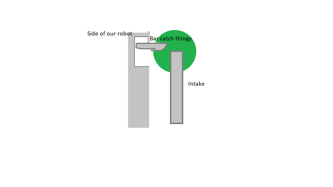

I was thinking something similar, we have a little piece of bar on the intakes that is hooked in a hole or something, dislodges when we spin the intakes. We used to have non-flip out intakes, but we found out in our first tournament that they are too short, and often will push the ball back instead of pulling it in. We think that having slightly longer intakes (which we can only get through having them flip out, as they are barely in the 18"-the only way we passed inspection was because we had a nice judge) will help pull them in better.
Here is my (kind of bad) paint render of my idea. This will only work it we use a something like what we have now, which is 2 gears screwed on top of each other with a generous amount of anti-slip mat and rubber bands wrapped around them. We could use Tread, too, and just use a stand off instead of the bar, maybe.
yes something like that could certainly do the trick.
