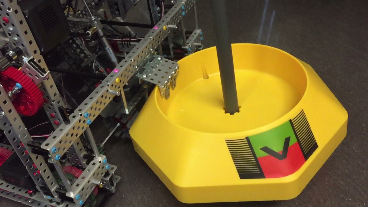

Here’s a video of the rear goal hook in action if anyone is interested:
The hook is powered by a single cylinder, and just drags a goal behind the bot.
It’s not super important, but it could be mildly useful in specific circumstances, and it has no downsides.
