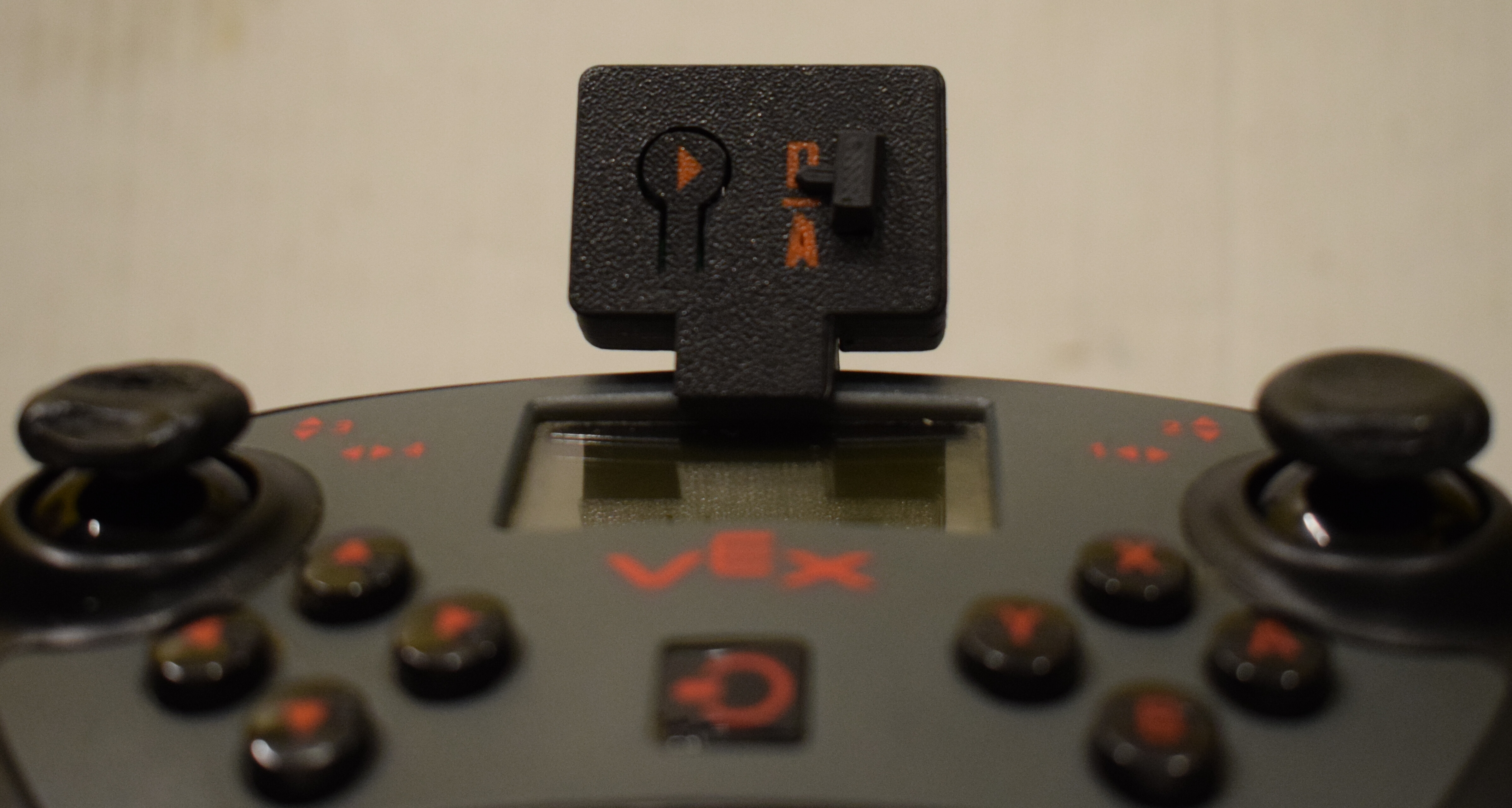

I have designed a timing competition switch for last season’s Make It Real Challenge. It clips onto the controller and can enable and disable the robot with the press of a button, allowing the user to have greater control of the robot. On top of that, it automatically disables the robot after the correct length of time has passed, closly simulating a competition enviroment and allowing teams to practice all forms of timed competion.
While I didn’t win the online Challenge, the teams in my organization have used it to great effect, and I brought a small batch of them to Vex Worlds. Many teams and Mentors there were intersted in it, so I published the design. More information available on my Github.

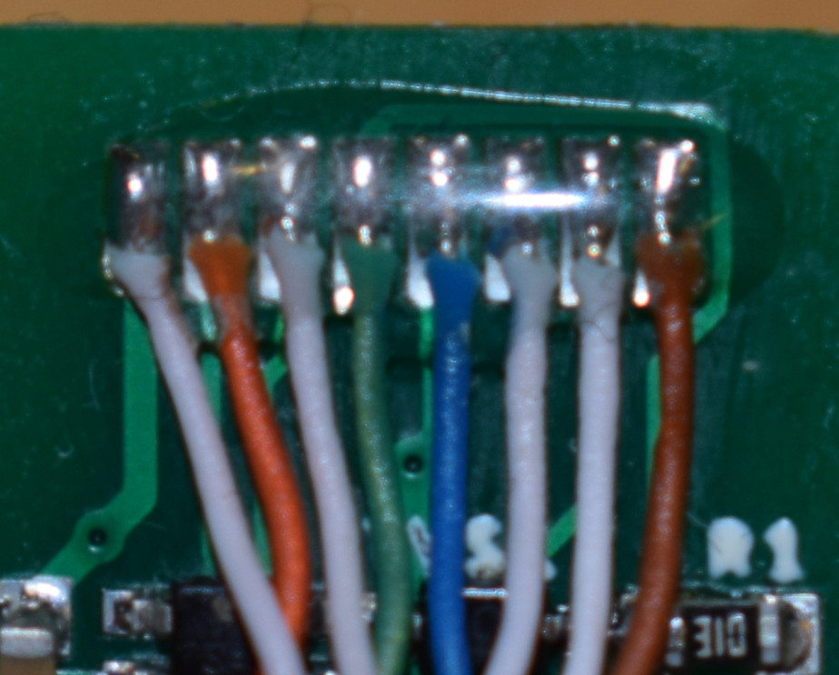

Dear VEX, please take note (from the linked github page):

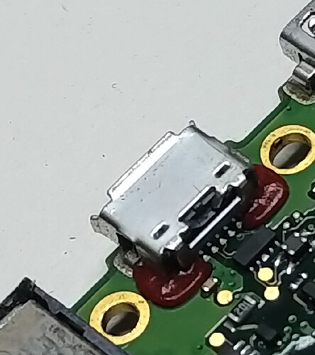

This is how you fix any PCB connections. A dab of UV-curing epoxy or something like that around corners of USB connectors and the reliability will greatly improve.
Below is an example of a similarly reinforced USB Micro-B connector on a consumer product (tablet) from 2012 or so):
This is cool! but what makes it different from the timed run and competition options already on the controller?
It is combining the benefits of the competition switch (more controllable and easy to switch from driver to auto) with the benefit of the times run feature (timed runs to simulate matches)
Great question, thank you.
The built in timer has 5 disadvantages, compared to my switch.
  1. The controller has no allowance for running a pre-auton longer than 3 seconds. I have always designed auton selection to be done via the screen on the robot, since it gives more information to the user and can enable a great variety of autons to be created. This cannot be done with the built in switch, since you don’t have time to select it. My switch is completly user controlled, so you can do what ever you need to do between the program starting and the timer starting.
  2. The competition mode will run driver right after the auton. This means there is no time to evaluate the auton, and, in the case that you are testing just the auton, you have to spend time canceling out the competiton mode between runs. Since they are two separete things on my switch, you decide what happens and when.
  3. The skills and competition modes take time to be disabled, so you can’t stop the robot immediately, because you have to press and hold the button. My switch can be disabled instantly with the press of a button.
  4. The competition and timed run modes kill the program right after it finishes, so if you output any form of telemetry to the screen, you don’t have time to check what happened to it. Since my switch just disables the robot after the time is up, this is not an issue.
  5. The controller has no ability to just run an auton for an indefinite amount of time. This can be beneficial for debugging the skills program as well as for autons which are used to test API capabilites. (One of the first things I always ran on a new robot was my “Square Dance” which drove the robot around a 2ft by 2ft square to test if my sensors were correctly calibrated. This was rather short, but for a more extensive test, an indefinite auton would be helpful.) On my switch, an untimed auton can be run by long-pressing the button when the slider is in the middle.
