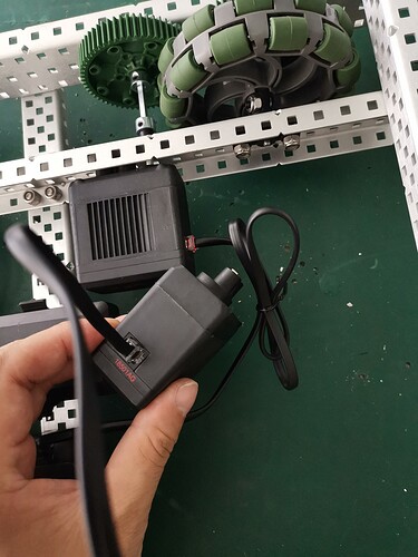

Using pros to test pid broke two motors, have you ever encountered this situation?Thank you very much.

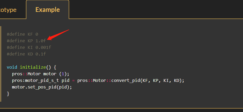

this is caution.
Example constants.
image is my change number.
Then Power on → control my joystick → my smart motor LED over.
may be that the P value is too large.
The real question is what did you put in for P?
From 0 to 5 for P value.
This is probably exactly what happened. Your k_P=5 constant is almost certainly well beyond what would be considered safe.

Changing the motor’s built-in PID gains is dangerous. Since VEX has not provided the default gains, it is impossible to figure out a good starting point and/or the scale the values are on. The values in the PROS docs are just examples.
Next, since this PID runs directly on the motor, I believe it has more direct access to the output power. I’m not sure if there is current/overheat limiting, probably. However, there might not be.
PROS did give you a warning. This has nothing to do with PROS btw, this is a VEXos command. However, PROS might be the only software that exposes that command, I would have to look at VEXcode/RMS.
It is easy to damage the motor if you change its internal control values, which is what that command does. Think about it. With much too high gains (I suspect proper gains are in the range of 0.0001 ), you will absolutely destroy the motor, because it tries to occilate so fast. Especially if there happens to be no limit on the integrated PID.
Please don’t continue using that command.
Instead, you can either use the default gains, or you can write your own PID loop that calls move() (voltage control). You can also look into using okapi’s PosPidController.
Those last two methods are user-based PID code (it runs on the brain) that ultimately will control motor voltage. This is the much safer way.

I would be interested to know what has happened to @Hubert’s motors, is this internal physical damage or is there electrical damage.
If the motors were purchased from Robot Mesh, they are not eligible for return under warranty.
Thank you very much for your reply, very helpful to me.@ theol0403
electrical damage double.
any idea what ? Does the V5 still detect them ? Do they turn if controlled from the V5 dashboard ?
