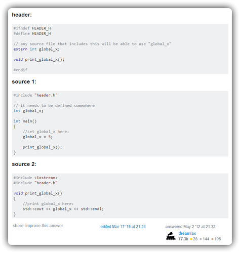

I had promised here to do a quick explanation on how to access global variables from several c++ source files.
The general idea is that global variables must be defined once only for the entire program. Any file that needs to access the same variable is told of it’s existence but does not declare it.
In main.cpp I declare two globals, instances of the motor class, LeftMotor and RightMotor.
main.cpp
#include "vex.h"
using namespace vex;
// A global instance of vex::brain used for printing to the V5 brain screen
vex::brain       Brain;
// define you global instances of motors and other devices here
vex::motor       LeftMotor( vex:: PORT1 );
vex::motor       RightMotor( vex:: PORT10, true );
int main() {
    int count = 0;
    driveForwards( 100 );
    this_thread::sleep_for(1000);
    driveForwards( 0 );
    while(1) {
        Brain.Screen.printAt( 10, 50, "Hello V5 %d", count++ );
        // Allow other tasks to run
        this_thread::sleep_for(10);
(main also want to call the function driveForwards we deal with that in a similar way to the globals as the function itself is essentially global)
In a second source file, drive.cpp, we have a single function called driveForwards that wants to use the LeftMotor and RightMotor variables.
drive.cpp
#include "vex.h"
void
driveForwards( int32_t speed ) {
    LeftMotor.spin(fwd, speed, velocityUnits::rpm );
    RightMotor.spin(fwd, speed, velocityUnits::rpm );
now to hook it all together, in vex.h declare both LeftMotor and RightMotor as extern. The driveForwards function is also declared (a function prototype).
vex.h
#include <stdio.h>
#include <stdlib.h>
#include <string.h>
#include <math.h>
#include "v5.h"
#include "v5_vcs.h"
extern vex::motor       LeftMotor;
extern vex::motor       RightMotor;
void driveForwards( int32_t speed );
And even more generally.
Just pointing out there is nothing special about vex.h or the vex specific functions. We use extern to tell the compiler “hey trust this variable exists and that it will be defined somewhere else”.
