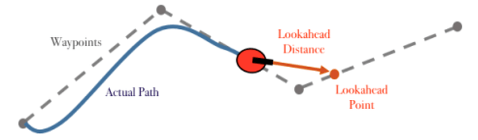

Hurdle 3: Motion
You will need to create a pure pursuit and odometry system if you want the cleanest replay system. I would strongly encourage looking into Jar Template or other open source code and try to see how they work fundamentally to make your own pure pursuit or boomerang solution. Even then, expect the robot to undershoot turn paths, just because thats how pure pursuit functions.
