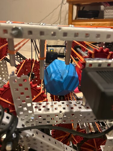

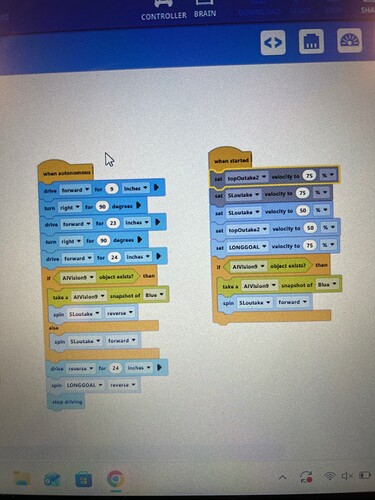

So we are at the last stages of our robot and we just have color sort to go. The problem is that when we start the code and there’s a block in the sight of the AI vision sensor, it does it when it starts but after we start it and we put one in, it doesn’t sort. Here’s a look at our code…using block btw…

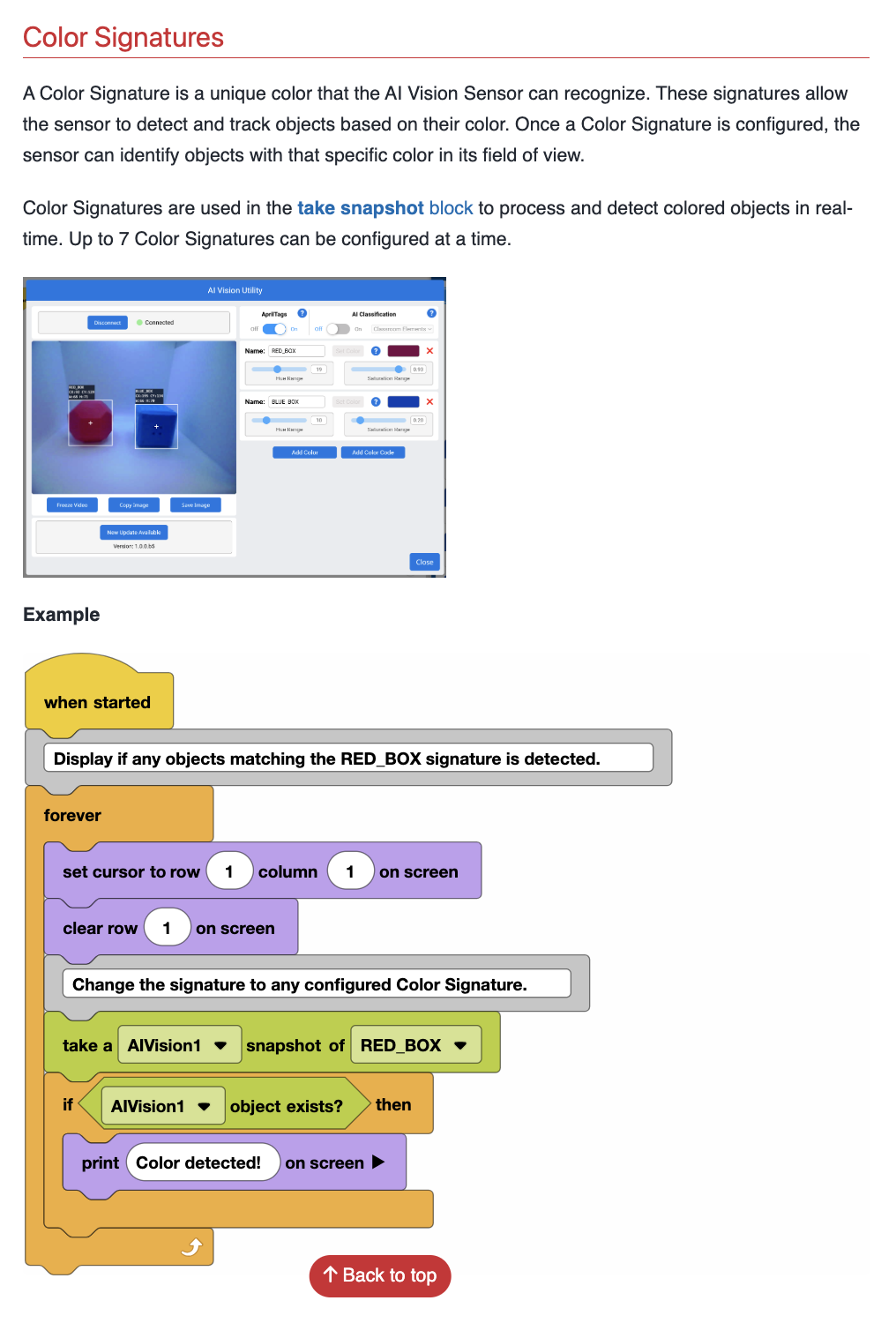

You need to be using take snapshot before checking if an object exists.

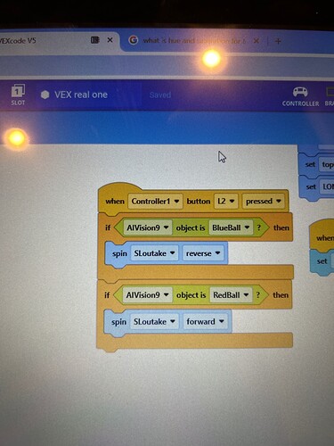

Update on code
Read through this page, you ignored my suggestion
(I also moved your topic out of the robot mesh studio support category, not sure why you thought it should go there)
It doesn’t really talk about color sorting. Or colors in general. Can you give me a guideline to how to code what I’m trying to do?? You don’t have to though. Thanks.
Did you not read this part then ?
For some reason I thought you were doing IQ, that’s why I linked the IQ api page.
here is the link to the V5 page, almost the same, just the block to get the vision data is named differently (why I have no clue) anyway..
same concept, block has a different name
