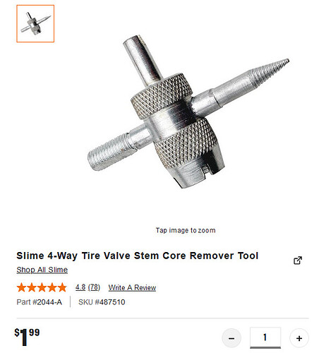

If from ‘inside’ the valve. Get one of these from autozone/walmart/etc.
Remove the core, check for contaminants/dirt/etc. Reassemble gently until leaking stops.
