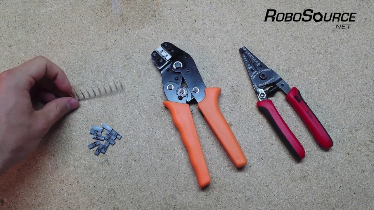

A forum user made this video to show how to do wire repair and it is exactly the same.
