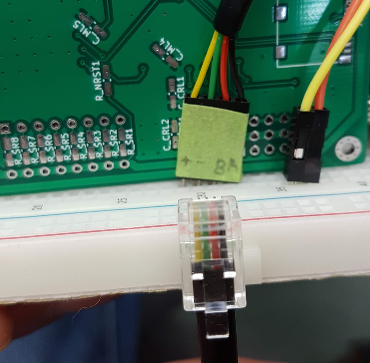

Talking to the V5 over a smart port really isn’t that difficult at all. They use UART over RS-485, so all that’s needed is a RS-485 transceiver. Each port is half duplex (meaning it can only send data in one direction at once, this is perfectly normal for RS-485), so if you want a normal full duplex UART connection, you need to use two ports and thus two transceivers. The way around this would be to have your own microcontroller (like an Arduino) to sit in-between the V5 and LIDAR sensor, but this will require a bit more work on your part (though it’s also not terribly difficult). Do note that the power coming from a smart port is straight from the battery (somewhere around 12V), so you will need to regulate it before doing anything with it.
This is a rough schematic of what you’ll need to do using two SN65HVD1782 transceivers, the RS-485 transceiver that I’ve used before (and that the V5 uses internally). It’s available from both Digikey and straight from TI in both SOIC and PDIP packaging (you’ll probably want PDIP unless you’re surface mount soldering it to a PCB, in which case also check the datasheet for an example as to how to do proper static protection which my schematic doesn’t include). I also included an L7805 voltage regulator, which is just a common 5V linear regulator, but any decent 5V or 3.3V regulator should work fine.
The pinout of the smart port is labeled in the schematic counting from left to right looking at the bottom of the plug (as is standard for modular connectors), the following image might make it a bit more clear.
