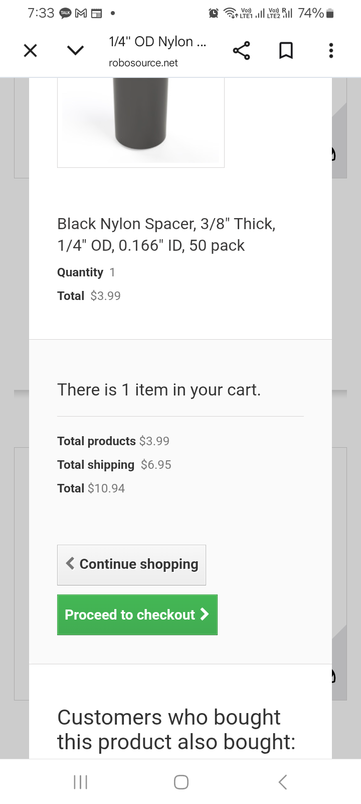

By access, do you mean you are not allowed to order them? If you are, then look at 1/4" OD (outer-diameter) spacers on Robosource. Strongly suggest the 1/8", 1/2" and 7/8".
Nah, we technically do have access to it, but my team is from indonesia, so the shipping cost and stuff are quite expensive. I’d love to know if there are ways that I can afford them at a cheaper cost, though.
Actually in hindsight, the prices might not be that bad. If the alternatives suggested above don’t feel enough, I’ll try buying some.
You should also be able to find these on other commercial supply websites, E.g. McMaster-Carr is a good alternative for the US, or Amazon. Both have a lot more options, which can be both a good and bad thing (more time searching).
