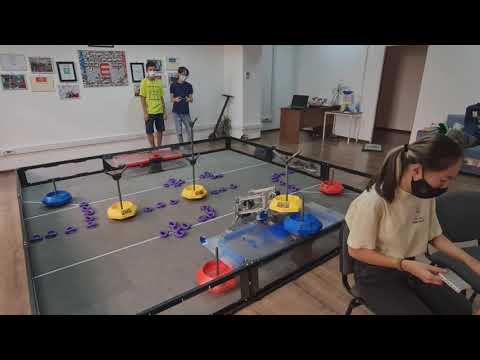

the easiest way to play the game effectively is probably a bot that can clamp goals, and lift them with a 4 bar or something onto the platform.
Here are some robots that can do this (some of them can also do other things, but for someone new I wouldn’t attempt those other things until you can get the basic grabbing and lifting down)
of course the best robots will be able to do much more than just grab and lift goals, but you can still perform excellently with this simple strategy. If you find that this type of robot isn’t enough for you, you can always add things like a rear goal lift or a ring mechanism, just remember that reliability is key. If you bite off more than you can chew, you won’t be able to do anything well.
