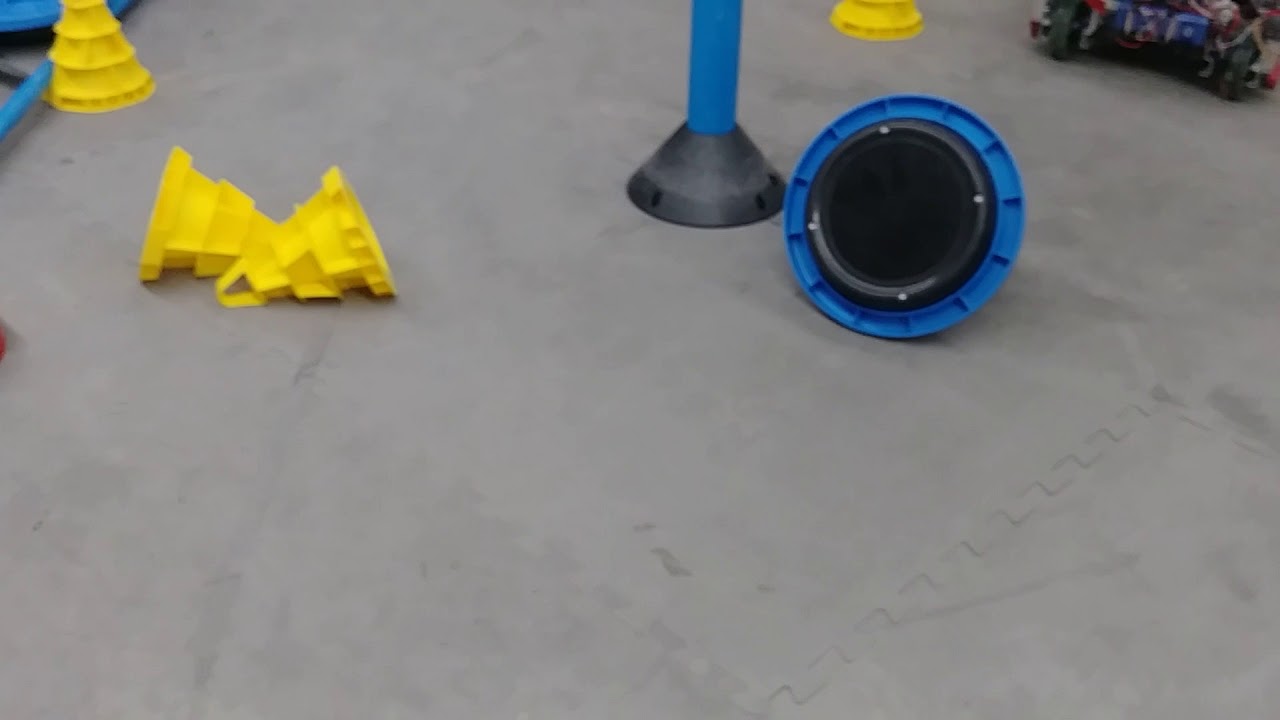

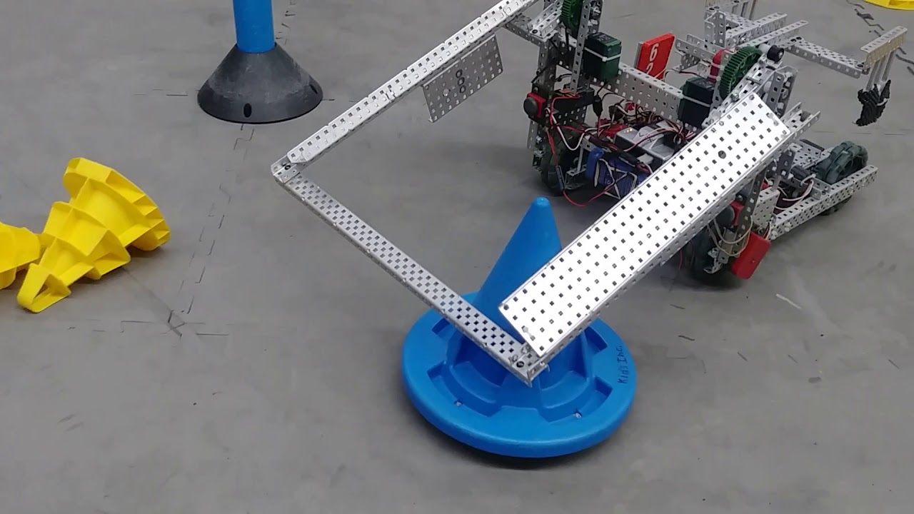

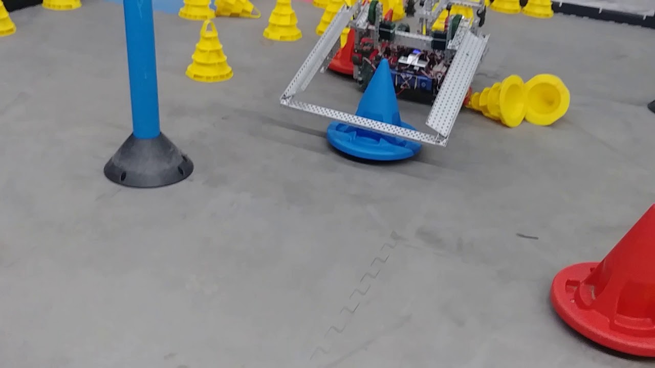

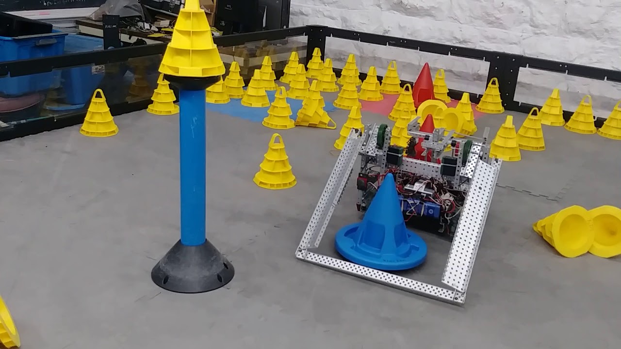

I believe I know the answer to all of these but there still seems to be some confusion so I wanted to ask these questions with video for reference. Which of these scenarios/actions are illegal, if any?
moving an opposing alliance mobile goal with a cage:
moving an opposing alliance mobile goal with a cage interacting with multiple surfaces or concave surface:
moving a mobile goal with a cage that is under the lower lip of the mobile goal:
tipping a mobile goal with a cage going under the lip of the mobile goal:
