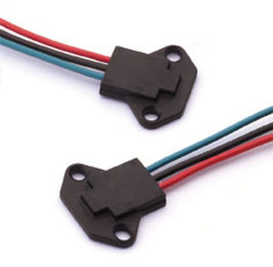

I always thought having Prox sensors would be amazing.
Especially with options like these:

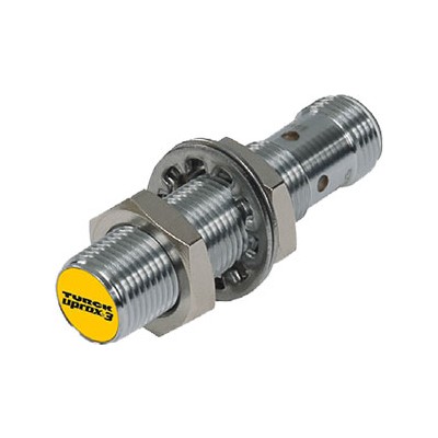

Or lets just take it a step further and allow V5 to talk to third part sensors… I do understand issues with Europe using PNP and America mostly NPN, but teams should be able to over come that. I probably should invest in Turck for how much we use it at work…They make really great sensors.
