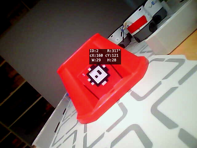

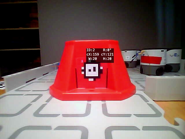

It should not be, but I know there were some tweaks for 1.1.6 to improve center coordinate detection. Same size and position both in vision utility and V5 below. If the tag is rotated, the width and height will be different as that defines a bounding box around the tag that matches how color and AI objects are described.
for this image in the utility
running a blocks program to just display data shows.
see how width and height have changed here.
