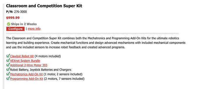

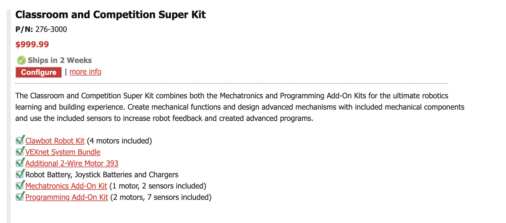

If we assume that originally you had bought these.
Most of the clawbot kit, excluding motors, motor controllers, will be legal. certainly the hardware, gears etc. you may want to double check on the steel chassis. value of these parts is only about $80 (it was a $150 kit originally)
vexnet system bundle, ie. cortex etc. - not legal
additional motors - not legal
battery etc. - not legal
the sensors in the mechatronics kit are legal as will be gears etc. motors not.
the sensors in the programming kit are legal as are the wheels, again motors are not.
Of that original $1000 price, well over 50% was tied up in the vexnet system bundle, motors etc. so there’s some value left but not much. You are going to have to add a lot to this to be able to create a viable competition robot, might just want to start out fresh with some V5 competition kits.
