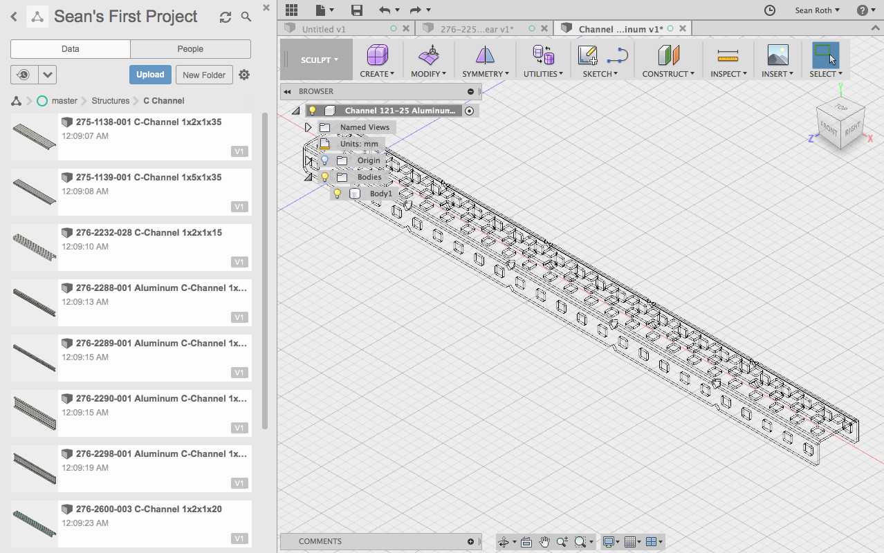

I’m having trouble, when i put the metal c channel for example in the design, it turns opaque, how to i change this.

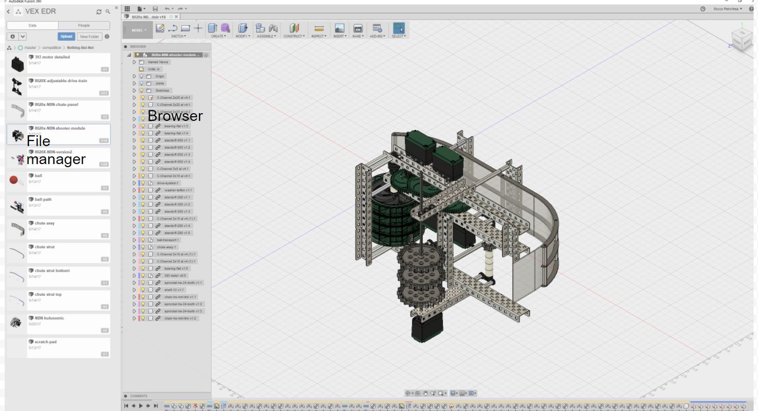

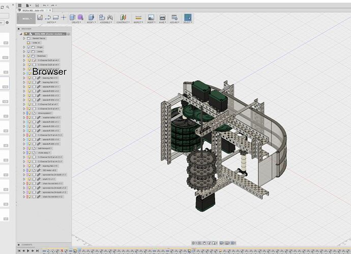

Can you attach a screen shot? I need to see the browser which is the list of components on the left of your work space, not the file manager.

is this what you need?
No that is the file manager. See the pic. I need to see your browser.
So this
I haven’t seen that, can you attach that channel so I can view it in Fusion? It is likely because of the native file type. Where did you get it from? I download the STEP files directly from the VEX product website. I might also be because you are in the sculpt environment. If you click on that tab you can change it to “model” which will also initialize a timeline.
im pretty sure it is from vex, but i also tried yours and it did the same thing. tried it in model still see through
could you maybe send the link from where you got them?
