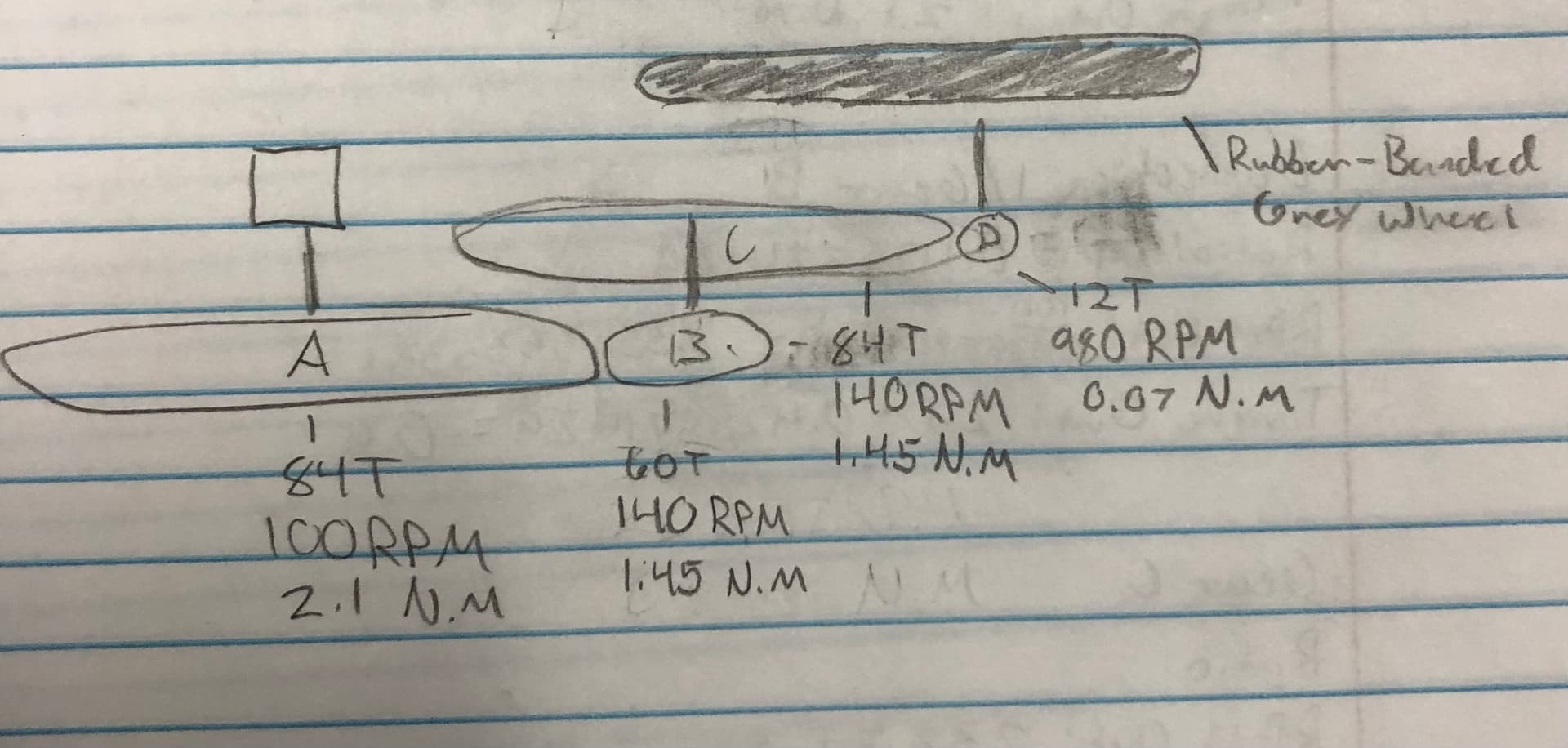

My new team has built a Disco robot and is modifying it to add a Flywheel. Here is the design.
This seems to have a very high RPM, but extremely low torque. Is this a bad thing? How should we be balancing RPM and torque? Is a more simple 84:12 ratio better?
Few comments:
  1. Most of the launchers are using a 3k rpm flywheel.
  2. Starting with a 100rpm/red cartridge is inefficient, try 600/blue if possible.
  3. Low torque is ok… you are storing energy in the flywheel, that’s the nature of a flywheel.
my team was successful in launching the discs near the goal (80% accuracy), by setting motor speed around 3000RMP. Watch out for the tension and friction as you put your gears together, since those factors can reduce speed/torque.
Any equations to find friction or tension? Where can I see those as problems?
I can help with the friction equation. The friction equation is F=μN, with F being the friction force, μ being your friction coefficient, and N being your normal force. Here’s a more in depth resource on how to find each of them individually, https://nfsi.org/wp-content/uploads/2013/10/Determining.pdf
