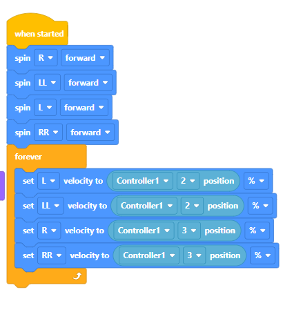

Set motor velocity to controller for each set of motors
I have two examples I have from previous years the first one is a six motor drivetrain controller using split arcade drive. If your team prefers tank drive it is a lot simpler and I have an example below but mine only uses 4 motors
Hope this helps!

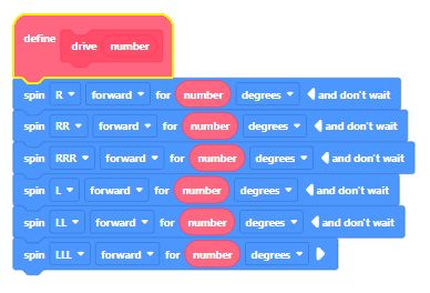

Thank you!!! My driver control is completely fine atm but I’ll test this out later… I just need help programming the autonomous if that makes sense :3 Do you have any examples of that? Because it’s not like the drivetrain command that Vexcode already has like moving a certain distance, like 6 motors make it super complicated for me to just program it to move straight or turn on its own (if that makes sense)

There are two ways to do this. Using the built in drive control or making your own control. For beginners, the built in is usually the way to go as it is fairly consistent if you input the correct values. On the other hand, custom control is much more consistent since you can tune the parameters yourself and better for longer autons. Reach out and decide which one you like the best and we will help
Personally I used a my block for driving in autonomous although you have to use degrees or turns instead of inches or millimeters. If you want to turn, just reverse all the motors on one side or have that side not turn at all (Depending if you want to turn in place or have a more curved turn.)
