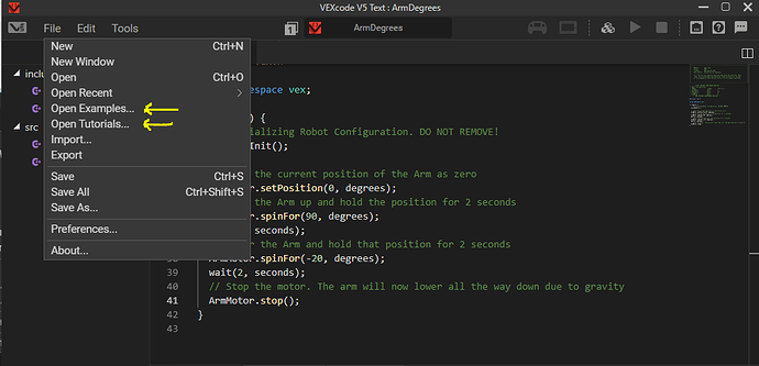

If you open up the VEXcode V5 Text editor you will be offered an array of programming examples and tutorials to help your team get started.
Oh thank you very much we will look into this right away!!!

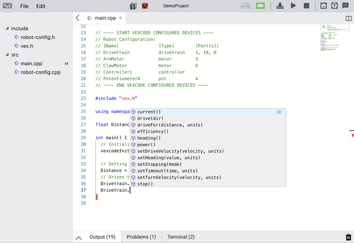

If you update to the new version of vexcode that was just released this week I would highly recommend using the drivetrain command for newbies. Basically you can initialize your drivetrain with 2 or 4 motors and then it gives you a bunch of options for simple yet accurate driving. You will need to measure your wheelbase and track width, and the setup shows you where to measure for those.
Unfortunately the autofill for drivetrain commands seems to be down with the latest update, so here is a picture with all of the available commands.
drivefor and turnfor are going to be your best friends in autonomous.
Lastly, the first thing I do in my classes is to make sure that the turns are going the correct amount. If your robot is over or under turning (I usually just make them practice with a 90 deg. turn):
  1. Set your stopping mode to brake using the setStopping command
  2. Fiddle with your track width and wheel base until you get get it to turn true. From there it should be pretty easy to get your robot where you want it to go.
