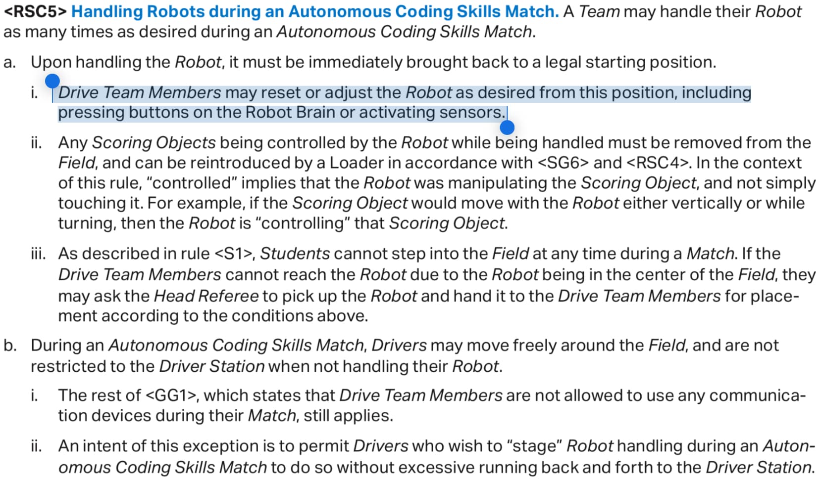

We are new and will be first time participants in a tournament in November. Reading over the rules and helping the team prepare, they are asking if they can reset their robot, and when putting it back into the legal starting position, pick a different autonomous program to run? Example, run program 1 for driver, program 2 for auto’s first stack of pins, reset, run program 3 for auto’s next set of pins, etc.
The rules in this section mention that students can reset or adjust and includes pressing buttons on the robot brain and sensors.
Is their strategy legal in this case to change programs for different autonomous events after each restart request?

Hi yes it is legal to reset the robot and change programs during autonomous matches as long as the robot is reset to a legal starting position and any game elements that the robot had possession of are removed from the field to be reintroduced through the loading station.
Yes. You obviously don’t get a preload pin every time the team resets, but otherwise just be in a legal starting position and don’t use the controller at any time and your team is fine. Our team has “auton 1” and “2” with plans for additional code programs if the kids are willing.

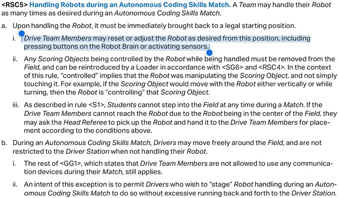

According to (RSC1) part (a) number (i.) it specifically states:
Drive Team Members may reset or adjust the Robot as desired from this position, including pressing buttons on the Robot Brain or activating sensors.
In other words, yes, you are allowed to change programs mid-auton match.
