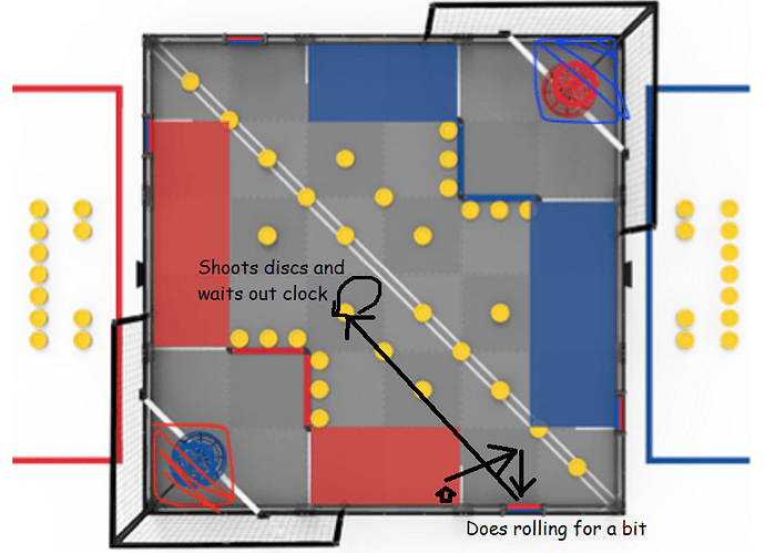

  //meant to turn bot at 60 degree angle with north (relative to picture) being 0 degrees

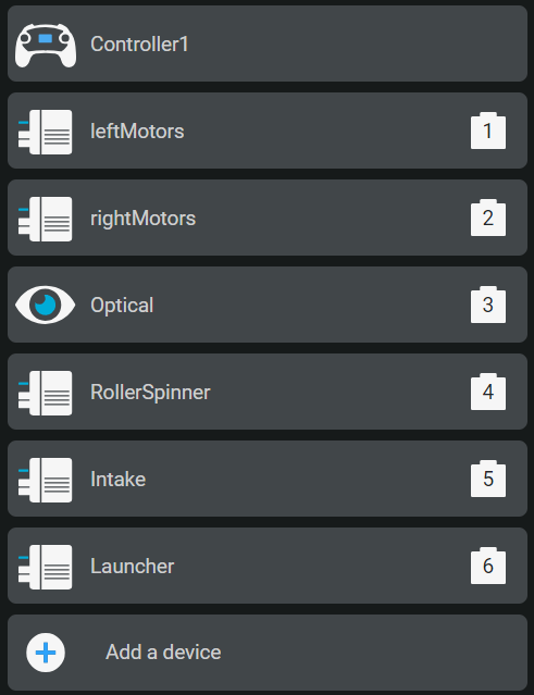

Here is the motors configuration I used
and here is the basic drawing of what should happen if I somehow got all those numbers right
