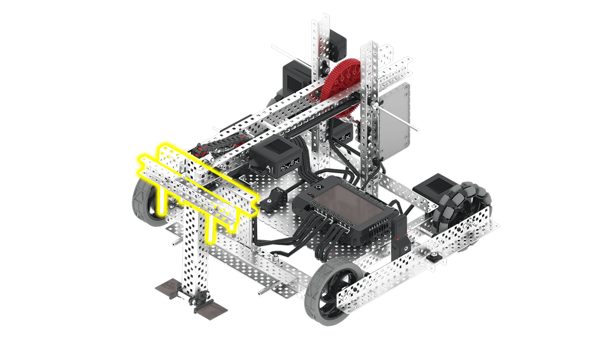

It is our school’s first time in the competition so we are keeping our build simple and sticking to the standard Axel Hero bot configuration. However, the chain in the pusher on the arm is breaking frequently - it seems to happen at the place where it is screwed into the metal pusher. Does anyone have any suggestions on how to work around this, as, if it happened in the competition, it would be very cumbersome to fix it. Thanks
By the “Pusher”, you mean the C-channel?
If that’s the issue, check what motor you’re using for it, the Axel bot we have doesn’t break that chain, and we’re using a red motor, double check your chain for weak points as well.
If it’s the flaps at the end of the arm breaking, that’s just a major design flaw.
Is the chain link itself breaking (like breaking in half) or the chains disconnect? (A picture of the broken link would be nice)
I assume its the former, so I would recommend not tightening the screw down as much. Since it’s breaking where you screwed it in, that’s probably a sign of over-tightening, which will break chains pretty easily. Tighten it until you can still shift it around, but with a medium amount of friction.
We are using the default green motor so that is certainly something I can change tomorrow. It is twice the rpm of the red. Also, you are correct - it is the C channel, as you have marked in yellow. Thanks very much for the response.
The chain disconnects - it doesn’t break. Yes the screw is very tight, so that is definitely not helping then. We will have a look at that tomorrow when I’m back at school. Thanks so much.
This is the part I was talking about to switch to a red motor if you want to be able to pick up 2 rings

So I talk from experience with the hero bot. First off the axel bot chain was very cumbersome when the chain broke and mine broke during our comp. So it wasn’t working you don’t want to make your chain to tight or too loose the mechanism is a bit confusing. If you’re talking about the pusher don’t screw it in too tight as it will end up making the chaining breaking off more. Also hope you guys like vex

We changed the chain and loosened the screw and that seems to have done it. Thanks very much. I am curious about how to pick up 2 rings at a time with Axel robot. We would love to know how to do this but any videos online only show this with more advanced builds than Axel. We are also curious to know exactly how changing the arm motor from green 200 rpm to red 100 rpm helps. It obviously slows the motion for lifting the arm but I’m not sure I understand why this is an advantage. More precise control maybe?
