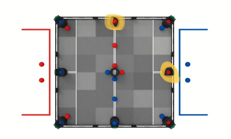

Here’s the thing. Matches become extremely predictable if that happens. If a team wins auton, they’ll immediately try and go for a diagonal. If they do that, both robots can defend middle and win. If a team doesn’t win auton, they’ll just lock the 2 corner goals on their side of the field. Since all the corners are locked, there are only four rows left. Teams will just defend their home row side goal and it’ll be a battle for the two auton line side goals. The auton losers can at best win by one point if they get that row and the center. So essentially, the auton winners only have to defend two goals to guarantee a win.
Locking balls is broken
It’s gonna become a game of who can win auton
Note: this argument only takes into account rows and not individual balls, but the point still stands imo.
Ik that that probably sounds very confusing so TL;DR the auton winner only has to defend the marked goals above on their side to pretty much guarantee a victory

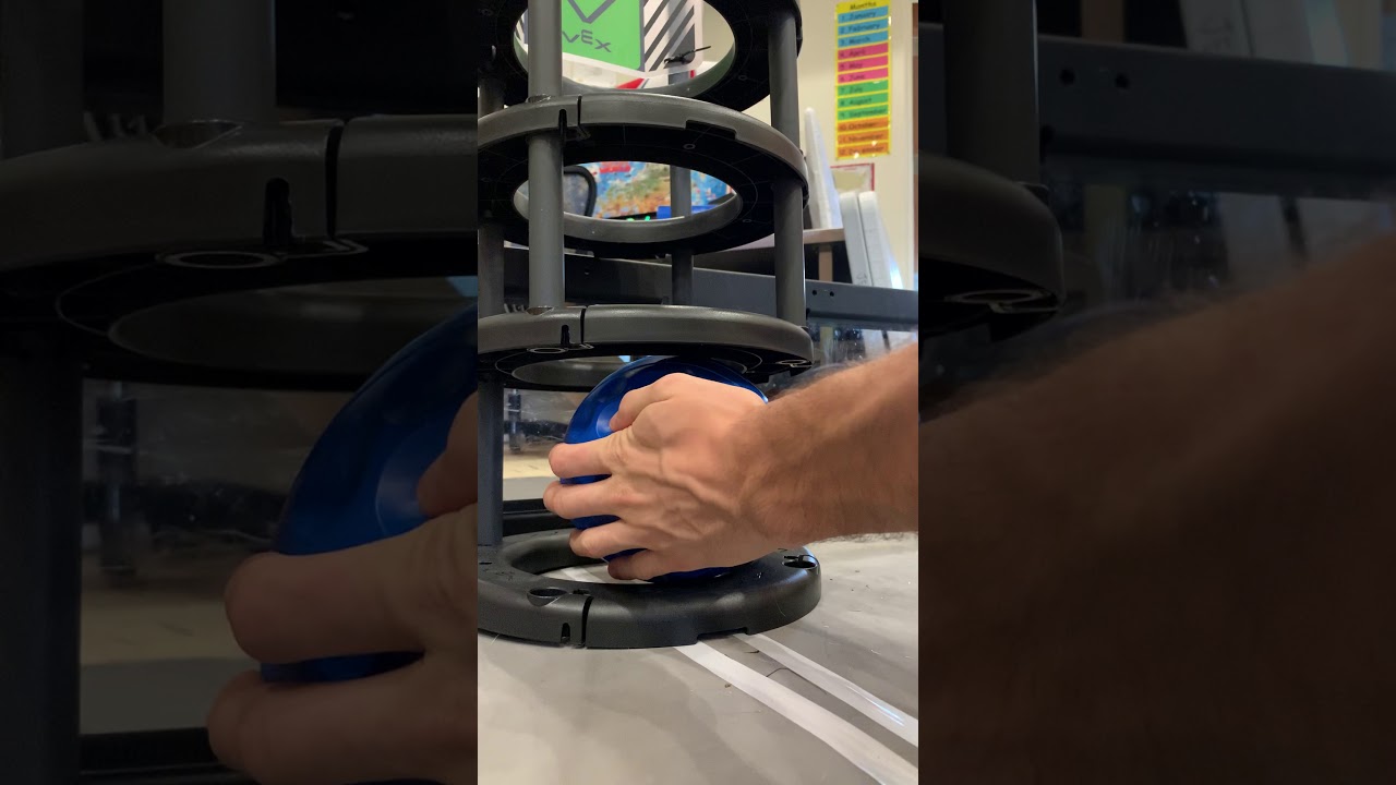

Crisis averted, it seems ez to take out
Thank you @224x, very cool.
Actually though, how fast are your intakes running and how far wedged in was the ball?
Idk this isn’t my vid I just found it, I think it’s all the way back though, and I think it’s VTOC robot

I think that goal isn’t set up 100% correctly. The #4 spacer was shown to fit snugly in between those rings in the center, but that second ring actually sags significantly, and the #4 spacer is supposed to be the space between the two rings right next to the post, which is probably higher on that goal. which means that goal is looser than a perfect one. I can confirm this just because there is no way any sort of roller would be able to dislodge the balls from my goals.
which is even worse imo, because the ±1" field tolerances will allow some goals to be locked, and others not to be. inconsistent. Which means that if the goals you start on happen to be lockable, and the ones your opponent starts on down, you immediately have a huge unfair advantage.

so have we determined how much total force it takes to actually remove a ball from a goal if it is just sitting in there normally?
depends on the goal, but generally not too much. 400 rpm rollers can do it fine
