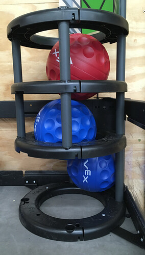

One of the kids discovered this today, quite by accident. You can hit the corner balls and they will jam tightly on the backside of the corner goals. This could have devastating consequences on robot design, game strategy, and overall goal of building/competing/etc as this sort of ‘shortcuts’ the anticipated game flow.

I’d this scored? I would think so, but I would like to debate. Also, can it be described? If not, you could make a goal yours for the rest of the game. Thanks for sharing this.
And the ring spacing is dead on. Precisely 6.13". These things wedge tightly enough you sometimes can’t remove them by hand (gripping from the sides using friction, you must get a finger behind them). FYI, the balls we have are not concentric. The diameter at the seam is ~6.1 and the ‘dimples’ is closer to 6.25.
It is scored. Top ball is clearly below top ring. Bottom ball does NOT have to touch the floor to be scored.

This is actually pretty scary. Being able to lock nearly half of the goals on the field could have serious consequences. How easy is it for robots to push balls all the way into the corner like that? Is it really impossible to remove them?
It’s VERY easy as they self-center as they are pushed backwards. It’s almost impossible to get them out with an intake/etc. They are simply too far back (approx 4" further than designed). They are wedged tightly. You can’t get access to the sides of them, being blocked by the pipes at the back.

wait but on the edge goals the two bottom rings are closer together than the diameter of a ball, how can a ball fit there? does it not go all the way between the rings?

This ONLY works for the corners.
They could change the 6.13" spacing and ALL these problems would go away. Change spacing, trim pipes a little, DONE!

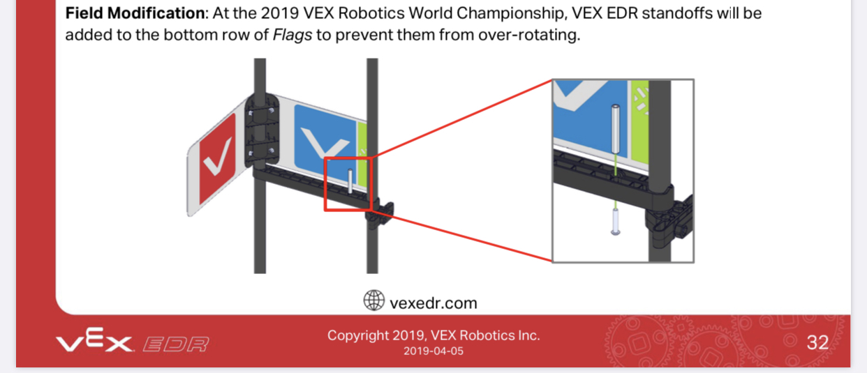

What exactly was the deal with the standoff thing in TP? I’ve heard of that before, but what was the problem?
Basically the flags in TP had a stopping mechanism so that if a flag was turned to one color, it couldn’t go any further. However, shooters were so powerful by the time worlds came around that flags were getting shot through that stopping mechanism.
