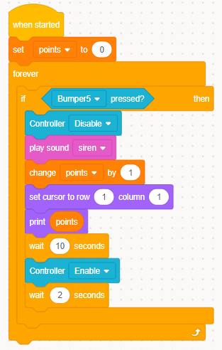

It could be like you have to add a limit switch to the but, and the other bot has to press it and it’ll stop working. The idea is to attack but to defend yourself too
You could just require them to add this to their code. It would disable the bot for 10 seconds and count up how many times they got hit. Also would give them 2 seconds to get away after coming back alive.
