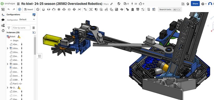

I haven’t used it for vex, but I have used onshape for my first tech challenge robot. it’s free and is web-based, so you can access it from any computer, and you should just be able to find a vex v5 parts library. the only problem with it is that it can become slow and laggy with big assemblies.
