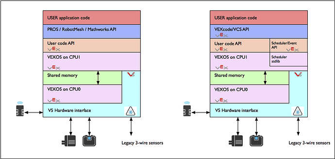

Since this thread is continuing a good discussion about VEX and C/C++ (API), it is probably good to note how PROS, VexCode, and RMS fits into the software running on the brain. Here is a post from James Pearman.
here is the image showing the software stack.
The RMS API is essentially the VEXCode API. It looks like the doc pages are copies. They also have many examples (click featured or public projects), but it is bit challenging to navigate to find what you want. VexCode has a more streamlined/simplified help (click tab VEXcode V5 text).
The PROS API is completely different, though it has all the same features but some are implemented in a different way (button pressed VEXcode vs PROS). To say one API is harder or heavier than the other is not really accurate. You could say the API documentation is easier or harder to understand. I find the PROS API documentation to be easier for me to understand. Probably because it is more similar to technical docs I’ve experienced in the past. I also like that there are examples for many functions. The extra comments here helped a lot.
