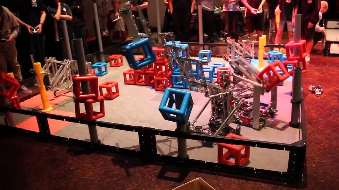

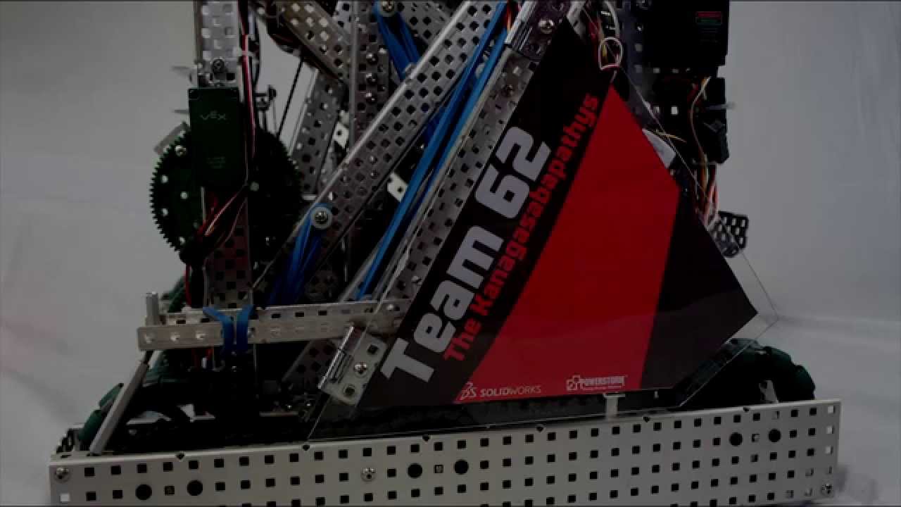

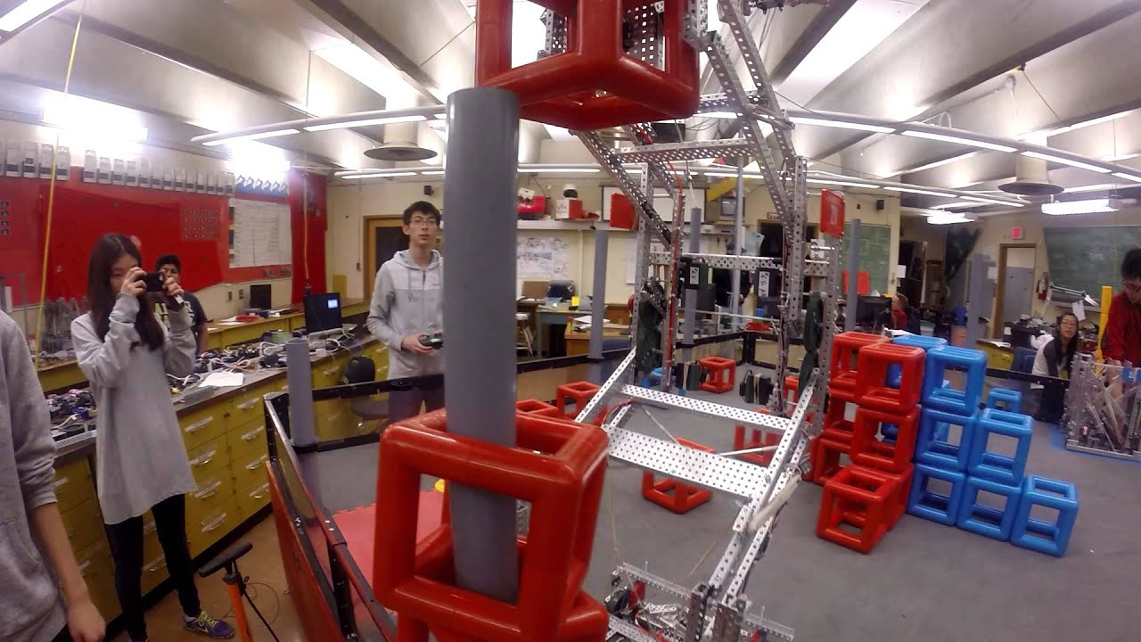

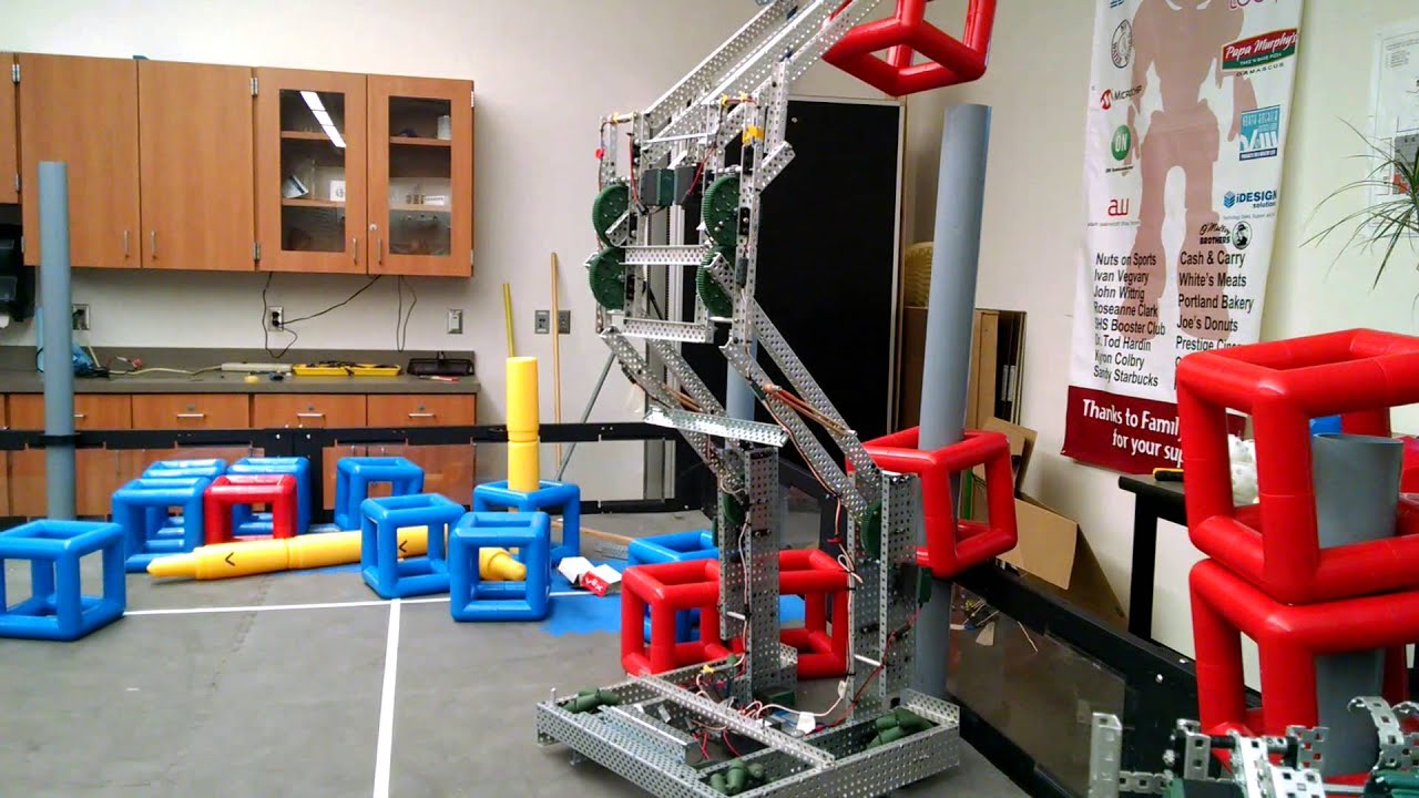

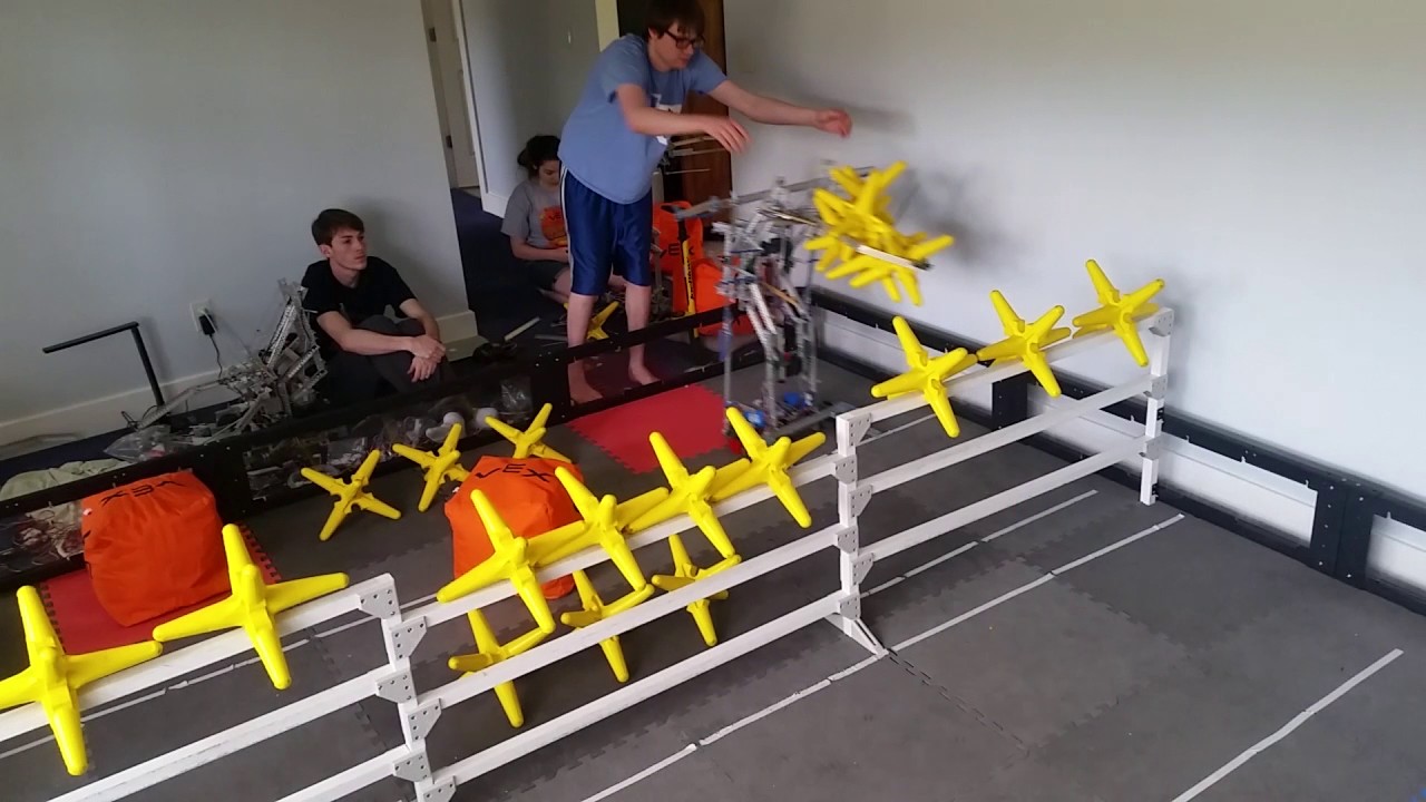

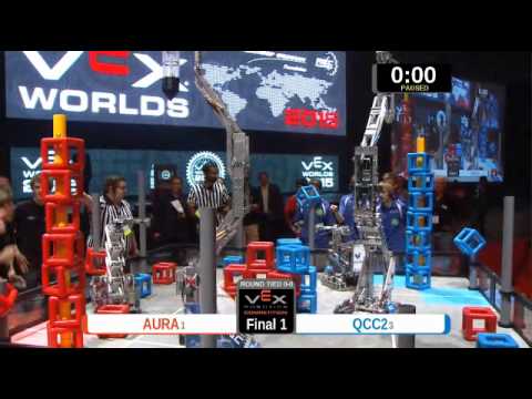

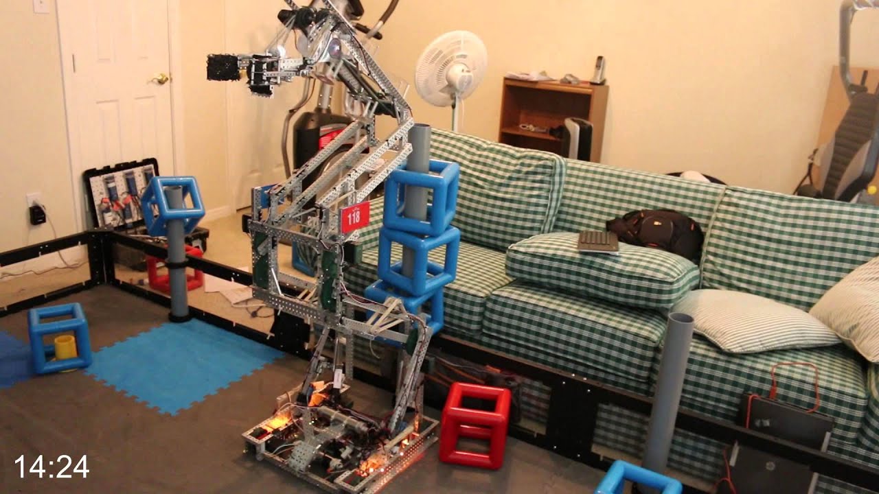

If you’re going for speed, 134D looked pretty good last year.

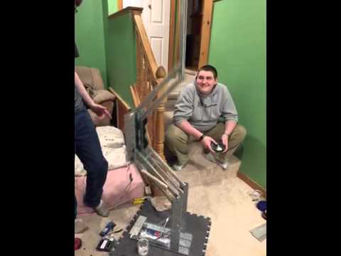

If you’ll excuse the music, we had a great time with our 11.7:1 RD4B during Skyrise.
Here’s one that’s a pretty basic design

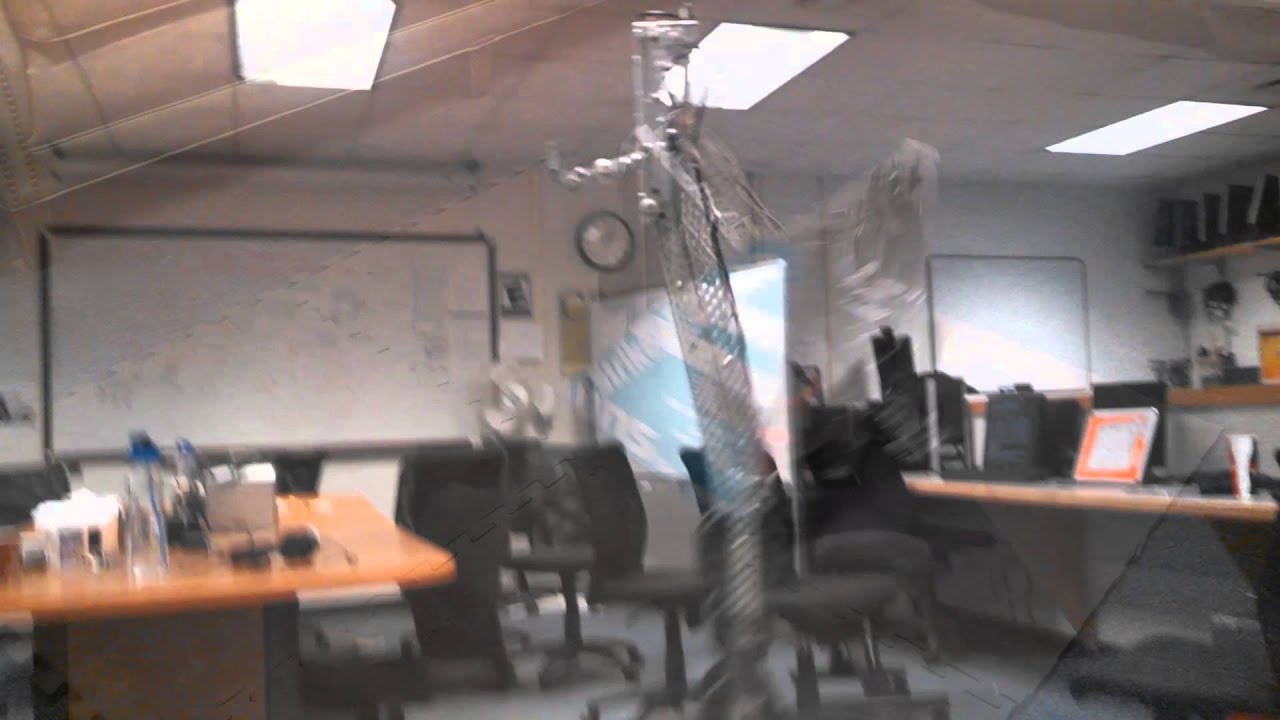

BNS Skyrise:
BNS Starstruck:
