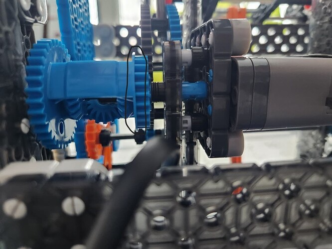

No wonder I had so much trouble with it.
The biggest issue I had was the little ridge sircled in black rubbing on my T-Fling gears and causing the catapult to not charge. These are also very bulky and hard to place, but are great if you don’t have pnaumatics and need both directions of movement for your subsystems.
