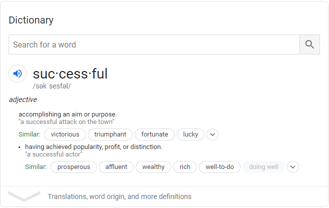

Successful has more than one definition. If successful for you is going to worlds, motion profiling and odometry are overkill (PID probably isn’t). If successful is winning Skills at Worlds, you need the most accurate and consistent programming possible. At that point, nothing that has been done in Vex as of now is overkill (in fact odometry and motion profiling are probably a must).
