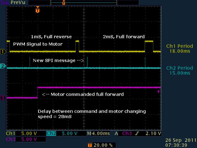

To see this happening in practice, some test code was written to monitor where the SPI messages were being sent and allow this to be captured on an oscilloscope along with the motor PWM signal and a trigger showing when a new motor speed was requested. The following screen shot shows a worse case condition where there is a large delay between requesting a new motor position and the next SPI message, and also a delay between the SPI message and the next PWM pulse being sent to the motor. It can be seen that there is a 28mS delay from request to motor control.
The next screen shot show a much more favorable situation where there is little delay between request, SPI message and PWM pulse. Although this is not the theoretical best case the delay has dropped to around 6.5mS.
Based on this information I leave it to the reader to determine a reasonable update rate for motors.
