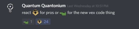

We had a vote last week on the Vex Discord server. You can tell it was a little biased =)
VCS: Never
RobotMesh: Newer? Haven’t really used it so…
PROS: Probably the best of them all
VexCode: Pretty decent, More streamlined than PROS for actually downloading in stuff but PROS is mostly otherwise better.
