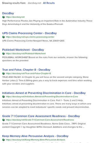

Is this another bot?
  • Account less than 4 days old
  • Only one prior post, just a generic “thank you” post (probably to get rid of the “This is the first time GlaucoGuerro has posted, please welcome them to our community!” banner
  • Weird reference to aquariums and safety windows, completely unrelated to vex
Yeah, definitely a bot.
