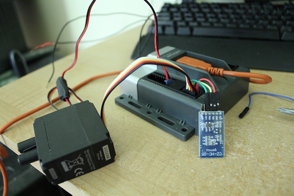

Hello all! One of things on Team BNS we have been trying to figure out is ways of sending and receiving data on the fly to be able to better debug our robots. Our initial approach to this is to use an HC-05 Bluetooth module that connects into the extra UART port on the cortex. There are a lot of advantages to using the HC-05 module like this, such as many computers and phones have bluetooth built in, so connecting to your robot should be pretty straight forward. Additionally, being able to send data to the robot will allow for quick adjustments for things like tuning PID controllers on the fly. Finally, it’s always fun to learn about UART if you don’t know much about it yet :slight_smile:
IMG_4016.JPGH]
Now what we’ve written is a small library that does two things.
First, allows you to reprogram your HC-05 module to different names/baudrates using AT Commands. This reduces the need to breakout an additional arduino or usb->uart dongle to change these internal settings.
Second, we have included a few examples on how to send and receive data over the UART port on the Vex Cortex.

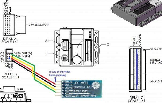

To set the HC-05 into a “reprogrammable” mode, set the key pin to 5V

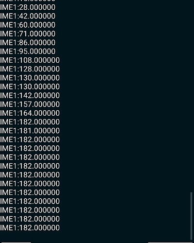

Here is screenshot from my phone when running the IMEBluetoothDemo.c file.
And the wiring from the HC05 to the cortex:

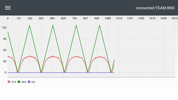

As a proof of concept, I was able to print velocity measurements from the IME’s along with the motor power, then use an app from the android app store to display those values on a graph realtime!
App I used here: https://play.google.com/store/apps/details?id=com.emrctn.BluetoothGraphics&hl=en
Code used on the cortex: https://github.com/JMarple/BNSBluetooth/blob/master/grapherDemo.c
The red line is the IME velocity calculations and the green line is the set PWM.

The “key” pin technically is 3V3, so there is a risk of damaging the HC05 if you connect it to the cortex’s 5V. Though, in my experience the HC05 can handle the 5V fine. If you’re concerned, you can create a voltage divider out of resistors to bring the 5V down to 3.3V. See this image.
