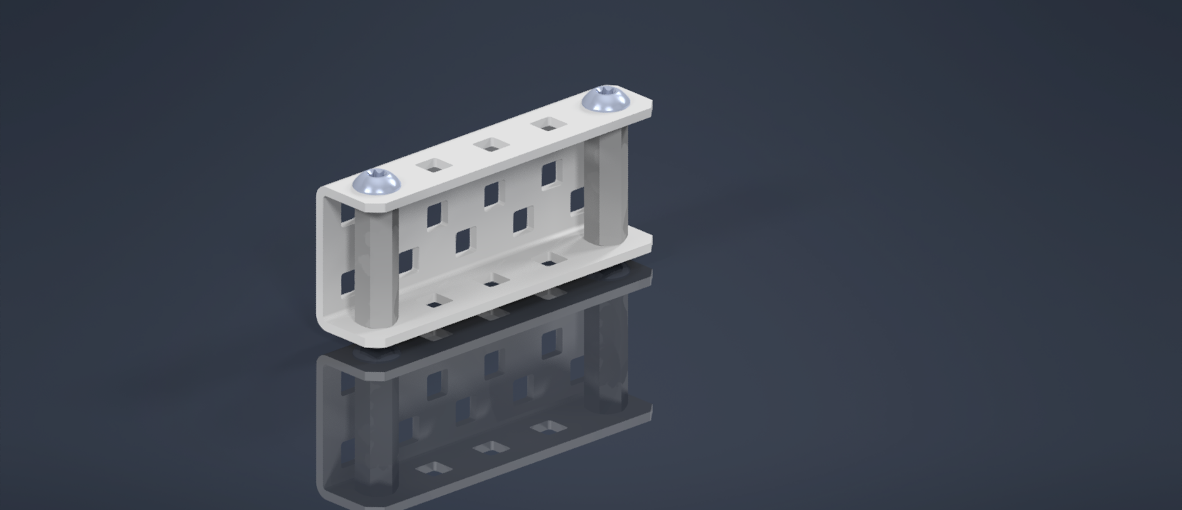

After re-reading @Xenon27’s post, I realized that using 7/8 8/32 standoffs from McMaster Carr could potentially solve all of these problems. Instead of having to stack multiple spacers to do the job, like so:
I could use one standoff in between, with a screw on either side, like this:
This would maybe be slightly heavier than the typical box-bolt, but probably not enough to make a huge difference. I would also probably put loctite in these standoffs, as these would make up a decent portion of my attachments and I don’t want them coming loose.
Are there any downsides to these that I’m not thinking of, or does anyone have any alternatives?
This certainly works, and would be extremely rigid, but I don’t think you’d want to use them absolutely everywhere. It’s very overkill for most applications, and while one standoff doesn’t weigh much, if you use them absolutely everywhere the extra weight is not insignificant.
But box bolting with standoffs isn’t a bad idea, and could have good applications in places where you really need a lot of rigidity.

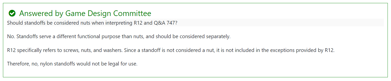

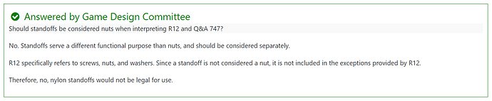

According to the GDC, they don’t:
https://www.robotevents.com/VRC/2020-2021/QA/778
Previously, I had thought that Robosource’s standoffs were legal because of R12. However, I think that they are legal through the rule that allows parts that are identical in ways other than color (can’t remember what rule it is), which their standoffs are.
I briefly considered using round standoffs, which could count as threaded spacers, but those aren’t legal- R12 specifically states "non-threaded spacer).

nowhere in the manual does it say you can use non-vex parts even if they are functionally identical to vex parts.
in fact, the manual specifies that you can only use official vex parts, with these exceptions:
<R12> Certain non-VEX screws, nuts, and washers are allowed. Robots may use any commercially available #4, #6, #8, M3, M3.5, or M4 screw up to 2.5” (63.5mm) long (nominal), and any commercially available nut, washer, and / or non-threaded spacer (up to 2.5” (63.5mm) long) to fit these screws.

Looks like these are legal now!
VRC Tipping Point Game Manual Updates - #12 by VEX_GDC
  1. Updated R12 to include standoffs
    Certain non-VEX fasteners are allowed. Robots may use any commercially available #4, #6, #8, M3, M3.5, or M4 screw up to 2.5” (63.5mm) long (nominal), and any commercially available nut, washer, standoff, and / or non-threaded spacer (up to 2.5” (63.5mm) long) to fit these screws.
