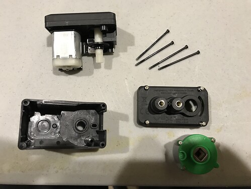

This is a picture from the teardown by @sazrocks. I will look into it this evening as we have a couple of broken motors.

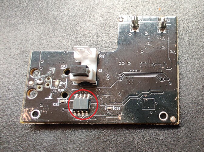

This is the motor PCB backside from one of our dead motors. The chip circled in red is the RS-485 to UART chip that if replaced could make the motor work again. With motors there is also an H-Bridge chip that could be dead.
Thanks for this! I was going to mark the chip, but didn’t get time to write this. In general, if the motor wire LED is flashing, even when connected to a known good port, this RS-485 transceiver is dead. If the motor reads as connected, but still wont spin or makes a whining sound, its probably the h-bridge mosfets. That fix is out of reach for most and the motor is probably dead. I have also experienced a capacitor failure which prevented the motor from powering at all. Replacing it fixed this issue.

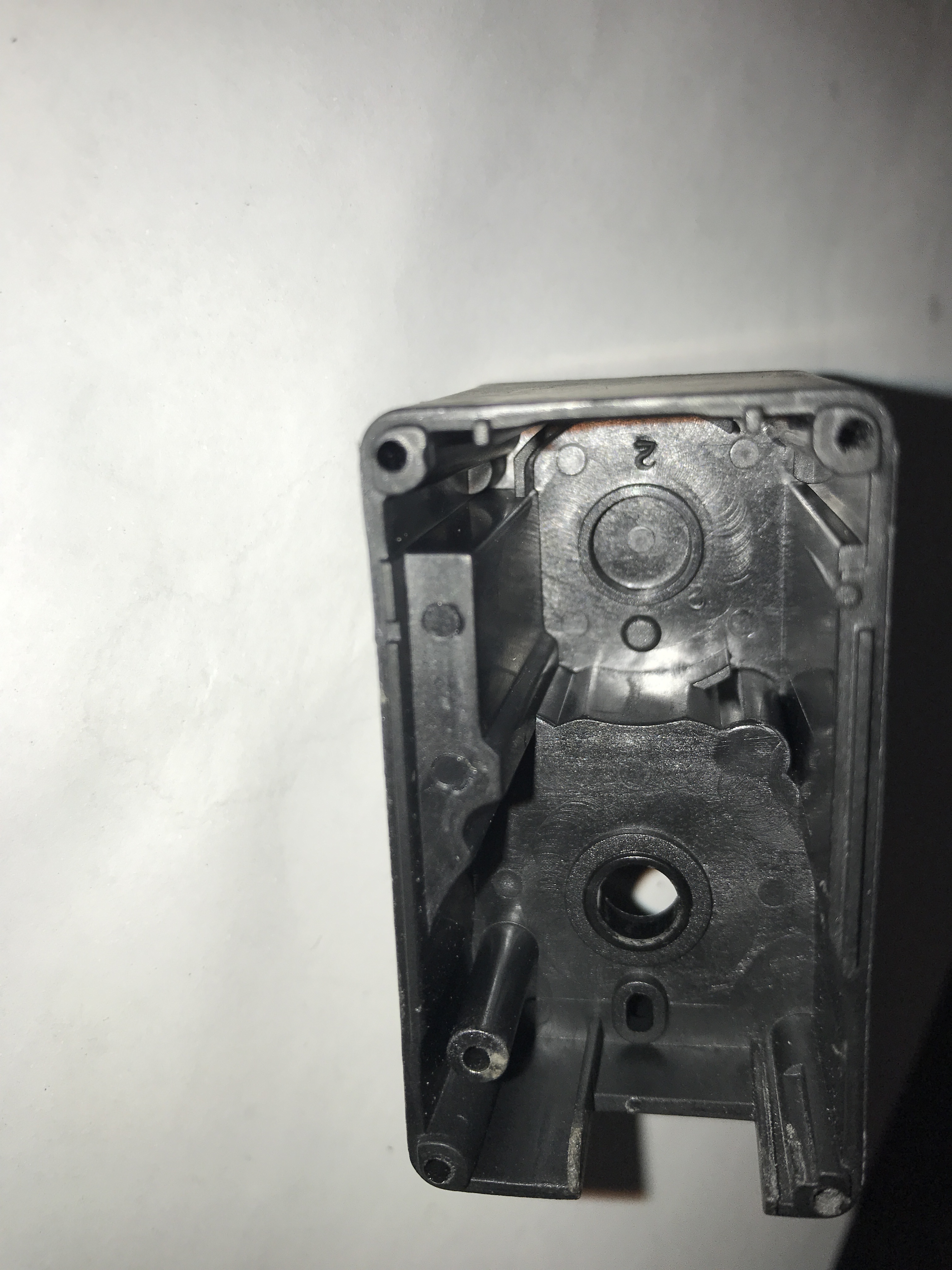

This is wrong. The center case of the motor is a single injection-molded piece of plastic. There is no metal. This is very clear from a basic disassembly of the motor, where we can see that there are no seams or gaps that would indicate the presence of a separate part made of metal:

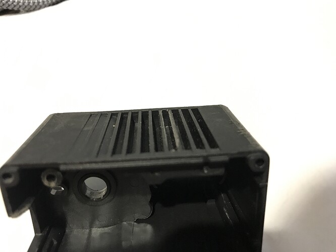

You can even see the injection molding marks on the area you purport to be made of metal.
I even scraped away the surface of the area you said is metal and found only plastic underneath:

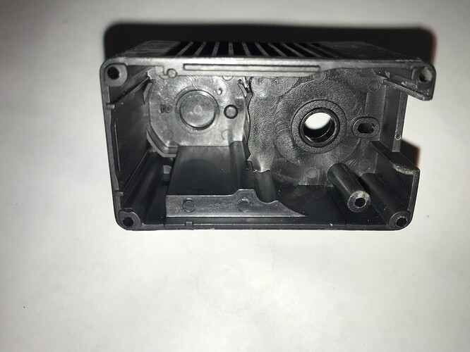

I stand corrected. The difference in sound, appearance, and direct contact to the motor’s can led me to believe is was metal. Still sounds very metallic when you rake across it with something hard. Ideas on that?
The different lengths of the fins of plastic lead to a different pitch of sound when struck. Think of the strings on a harp, or the effect that different finger positions have on the pitch of a guitar.
I’ve got that part. Thing is, they are longer/deeper than the other side so the sounds should be lower. It’s not. And it’s got a distinctly metal sound like cooling fins on a small engine, cpu heatsink, etc. Very strange.

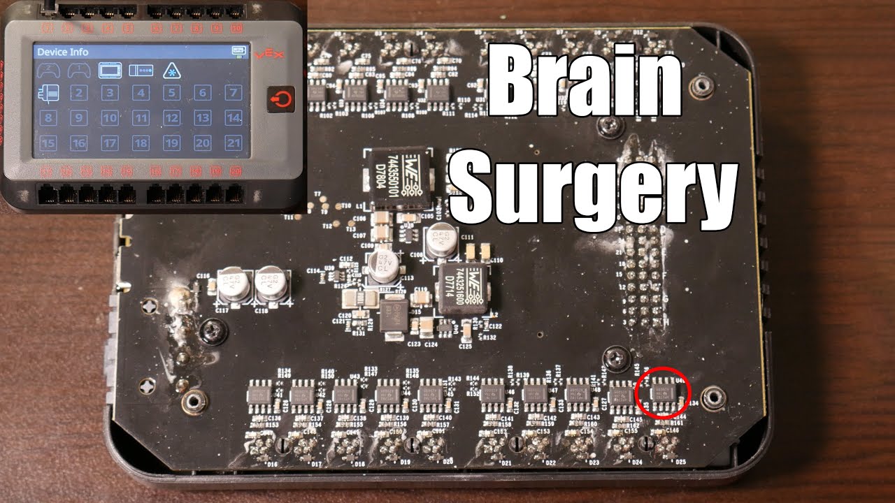

Its been a while, but a friend of mine did a great job creating a step-by-step guide for repairing a v5 brain. It is much improved from my text guide and adds from lessons learned after I wrote my original post. If you are at all interested in repairing your, give this a watch!
