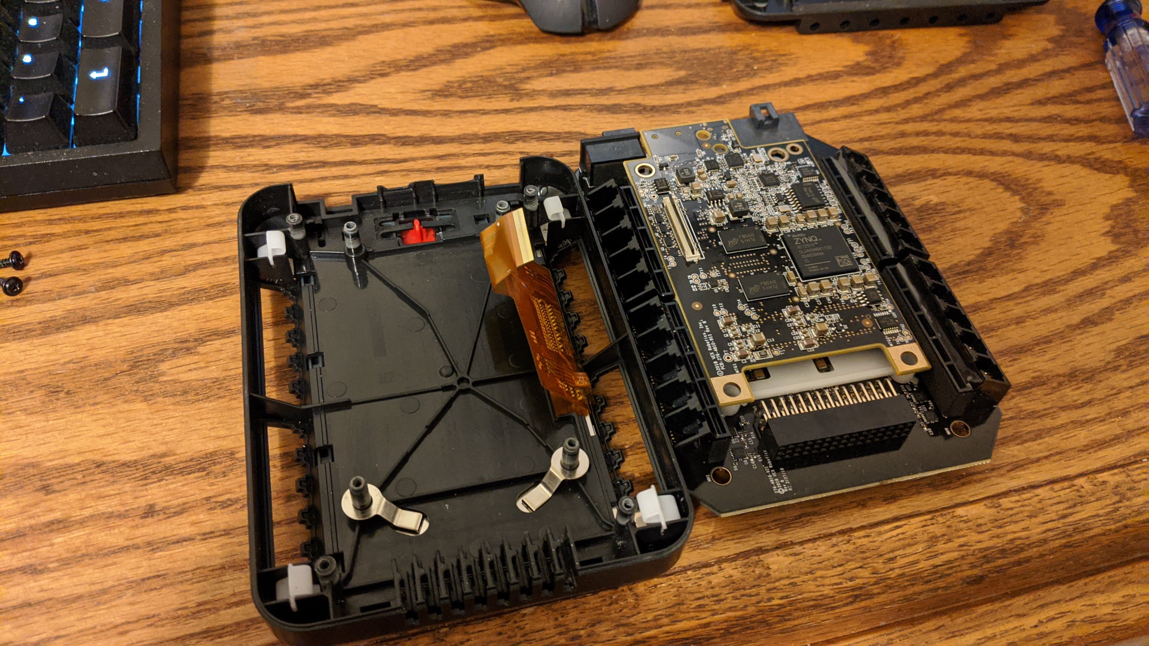

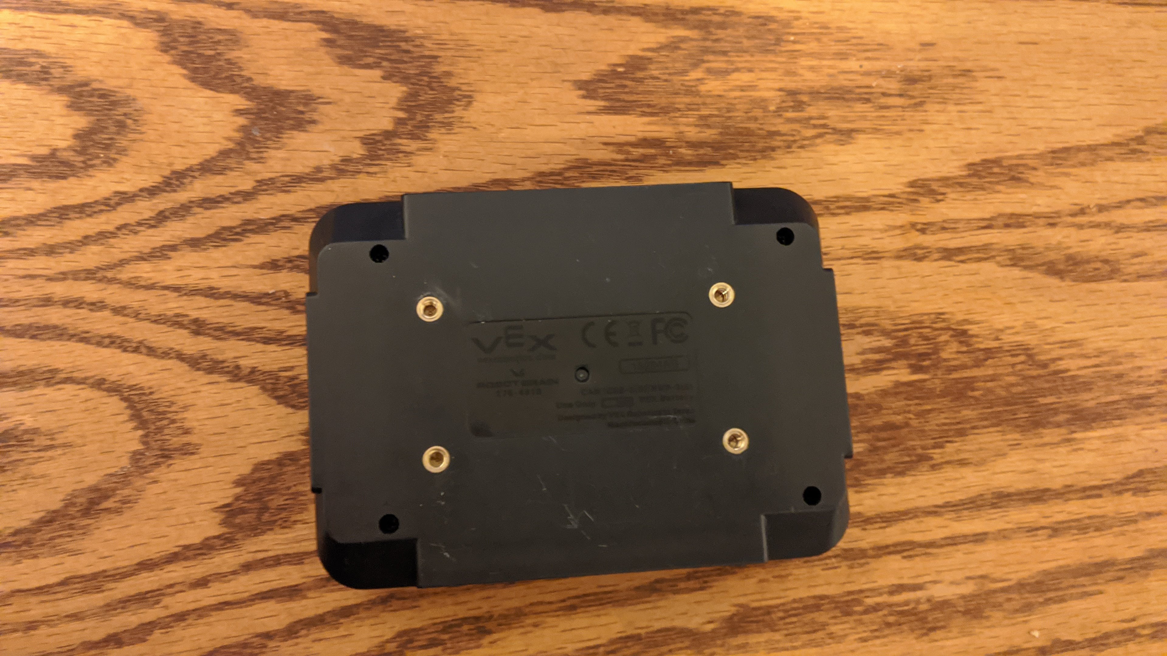

  1. Remove all power and cables from the robot brain, find the 4 screws in the back of the brain holding the two plastic halves of brain together. Remove these screws
  1. After removing the screws, the clamshell frame halves can be separated.
  2. Visible are the RS-485 chips we will be replacing. These are attached to the first of two circuit boards in the V5 brain. This board handles power distribution and communicates through a connector to the LCD and compute board of the brain. This board can be removed by gently pulling the board out of the brain at this point.
For this repair , I would suggest going no further into the brain unless you intend reflow solder components back on. This is an advanced soldering technique which I am not covering here as I don’t fully understand how to do it. There are a series of plastic parts in the board beyond the mounted parts which can fall out and be lost.

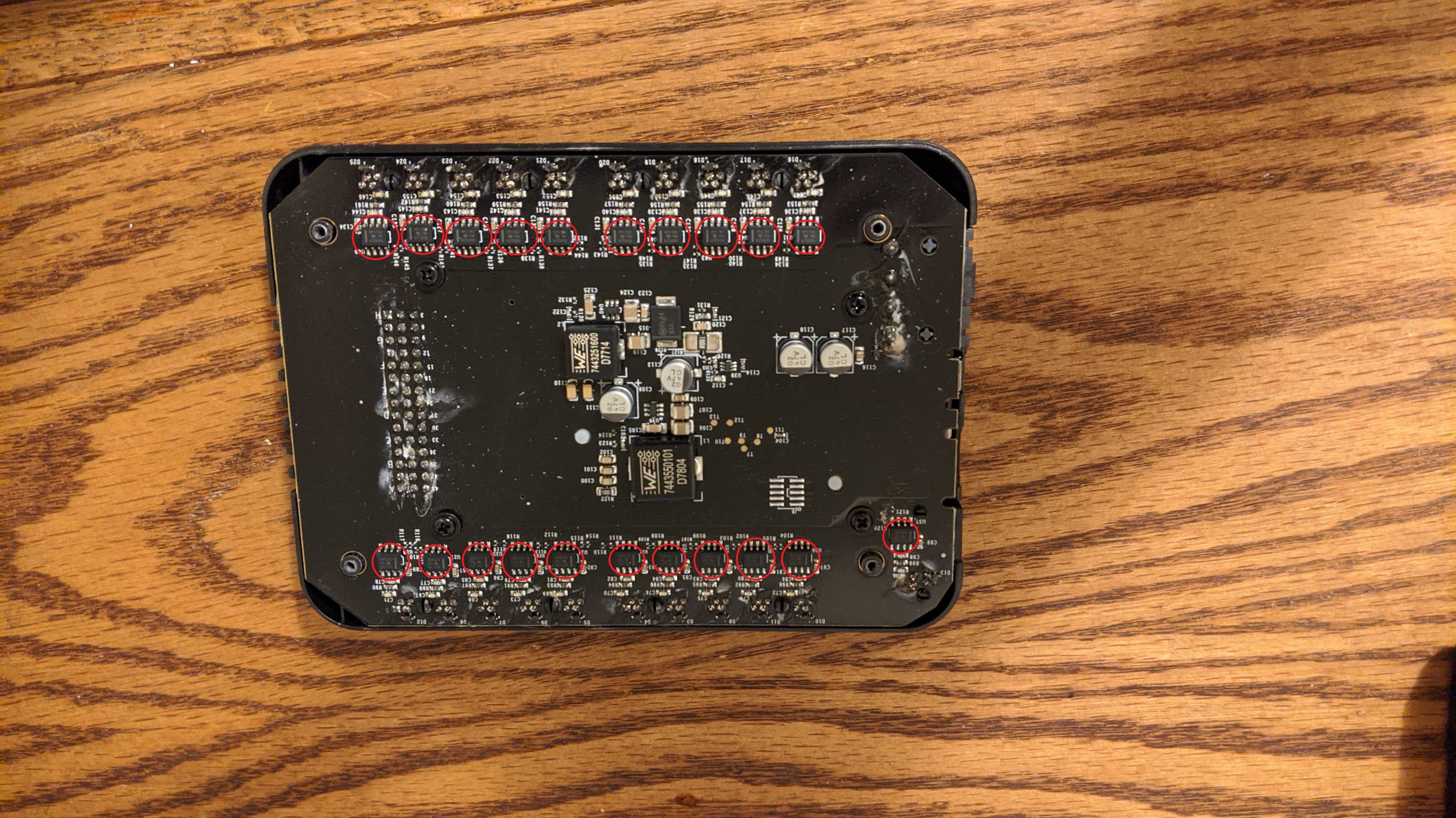

  1. Identify which chips are to be removed. If you marked the dead ports with cable ends, the ends will be in the smart port sockets in the front of the board. Use the solder wick to desolder the damaged chips and remove them.
The bottom right port chip is port 21. The next chip to the left of this one of the above picture is port 10. The upper right port is port 20. The remainder of the RS485 transceivers on the brain follow port definitions on the exterior of the brain.

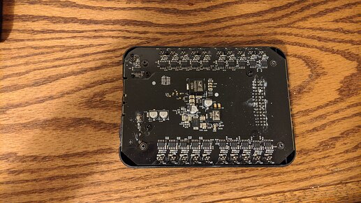

  1. Clean the pads carefully and tin the pads with solder.
  2. Place a new rs485 chip and solder the pins to the board. Check the orientation of the chip, the vertical bar printed on the side of chip should be on the same side as the other chips in its respective row.
  3. Check all the RS485 chips for bridged pins from soldering. A bridge occurs when solder connects two adjacent pins together instead of to their respective board pad. Touching the iron to these points will usually separate them. Failure to do this step could permanently damage ports or the brain.
  4. Reassemble the brain, replace all screws and power on the brain. The repaired ports should be functional. No further work is required. These devices are integrated circuits, and as such have no firmware.
