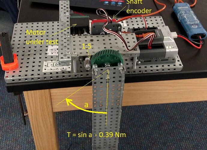

Build a Dyno
Another robot dinosaur? No, a dynamometer. A what? It’s a test machine to measure motor performance. It provides a load against the motor under test (MUT), varies the MUT’s speed, and measures the speed and torque. With a dyno you can determine the strength of each of your 393 motors, and find out how it’s geared without opening it up. There is a clamp to hold the 393 in place without screwing it down, saving time and wear when testing many motors.
This simple dyno uses gravity to provide the load and a VEX Shaft Encoder to measure position over time. From the position measurements you can calculate speed and torque. The encoder measures the angle from vertical in degrees. Speed is the change in angle divided by the change in time, scaled to revs per minute (RPM). Torque is the sine of the angle times the moment arm of the pendulum, scaled to Newton-meters (Nm). Moment arm is the weight of each piece of the pendulum times the distance from the pivot to the center of gravity.

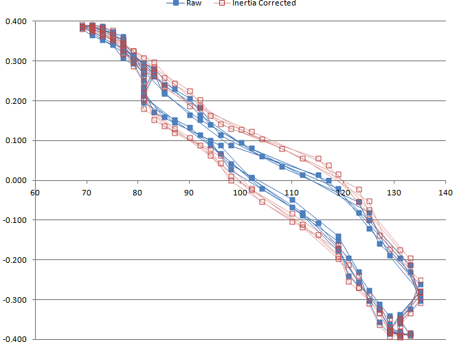

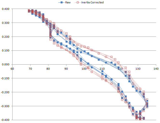

Here’s a sample run on a 393 geared for torque, at max power of 127. The horizontal axis is speed in RPM, and the vertical is torque in Nm. Blue points are the speed and torque values calculated as above. Red are supposedly corrected for inertia of the pendulum, since it is slowing and speeding as it turns. I was hoping the inertia correction would reduce the loopiness of the data, but I was careful with signs and they only got more loopy. It doesn’t seem to matter, though, because the best-fit lines (via linear regression) through both datasets are nearly identical.
Extrapolating the best-fit line to the vertical axis (the y-intercept) should give you the stall torque of the motor, that is, the torque at zero speed. Also, the horizontal crossing (the x-intercept) gives the no-load speed, that is, the speed at zero torque.
But is the torque-speed curve really linear? There does appear to be a slight downward curve, especially at negative torques (higher speeds). I think this is due to increased friction of the gears (both internal and external) at higher speeds, and friction generally goes by the square of speed. So I modified the linear regression to apply only to positive torques in hopes of minimizing the non-linearity. Still, using best-fit lines on curved data means that the stall torque and no-load speed calculations will be somewhat over-estimated. While not exact, they will be useful in comparing motors with one another.

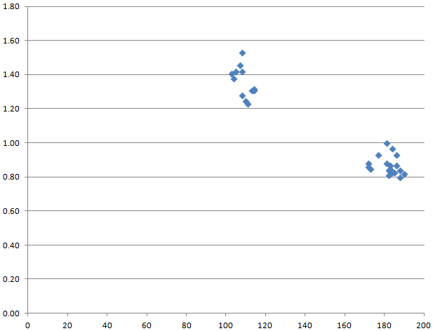

I ran the finished dyno 3 times on each of 10 random motors. The spreadsheet shows the results. I am satisfied with the repeatability of better than 5% between runs on a given motor. It is easy to tell a torque-geared motor from a speed motor. I have not yet tried a turbo-geared motor. Here is a scatter plot of the 30 runs.
127.xls (86 KB)

First it clears the encoder. It is important to make sure the pendulum is hanging straight down before running, so as to get a good zero angle reference. Then it records the battery voltage and turns on the motor at full power. For 16 seconds it records the angle every tenth of a second, then turns off the motor.
Next it initializes the linear regression sums. It skips the startup readings and analyzes 150 data points. Speed is found at each time step by subtracting the angle at 0.2 seconds in the past from the angle at 0.2 seconds in the future, like a moving average over a 0.4 second period. This gives a speed resolution of about 2 RPM. Torque at each time step is the sine of the angle times the moment. For each step it writes time, angle, speed, and torque to the DebugStream window, and adds torque and speed to the regression sums if torque is positive.
Once all data are in, it calculates slope and y-intercept of the best fit line, y = mx + b . It then writes out the battery voltages before and after the run, the free (no-load) speed, the speed at maximum dyno load, and the extrapolated stall torque. The DebugStream window in RobotC allows you to save all this to a text file.

This is how the speed calculation is scaled:
S = ( delta A in degrees ) / ( delta T in seconds ) / ( 360 degrees / rev ) * ( 60 seconds / minute ) * ( 5 gear ratio)
  = ( A(T+0.2) - A(T-0.2) ) / 0.4 / 360 * 60 * 5 rev / minute
  = ( A(T+0.2) - A(T-0.2) ) * 2.083 RPM
This is how the moment arm is calculated, given the weight of a 35x5 steel c-channel as 0.678 lb, according to the VEX site, and the distances from the pivot to the center of each c-channel as 8.5" and 17":
M = 0.678 lb * ( 8.5 inch + 17 inch ) / ( 0.225 lb / Newton ) * ( 0.0254 meter / inch ) / ( 5 gear ratio )
  = 0.390 Nm
