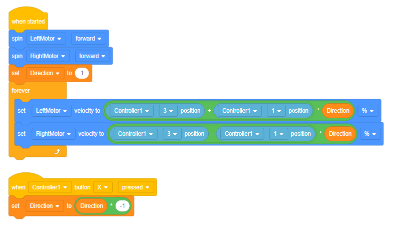

Here is a another approach. You could multiply the velocity value by a direction variable.
If direction is 1 then the robot moves forward, and if -1 then the robot moves in reverse.
The controller X button event multiplies the direction variable by -1 each time the button is pressed so it will flip from 1 to -1 and then back to 1. (-1 * -1 = 1)
Using the convert to text feature in VEXcode V5, this worked with some tweaking! Thanks!
