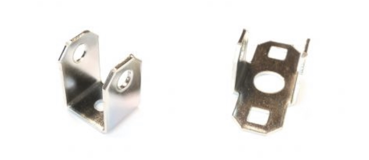

Also, is there a good alternative to the rotating mounts that come with the kits?

Solenoids have to come for vex because they have a special voltage for the coil, along with the solenoid connector (control cable). There’s also some little brackets for the pneumatic cylinders, but you can Fab those from Vex metal yourself.
