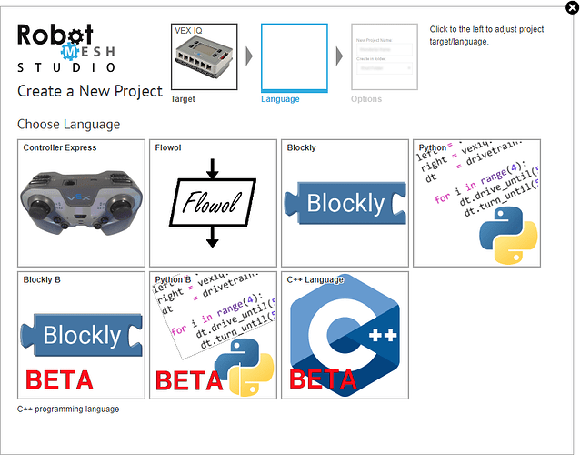

We are happy to announce that C++ programming has now come to the VEX IQ with Robot Mesh Studio. Program online at no cost at www.robotmesh.com/studio. Choose New Project, VEX IQ and C++ to code with the power of object-oriented C++.
