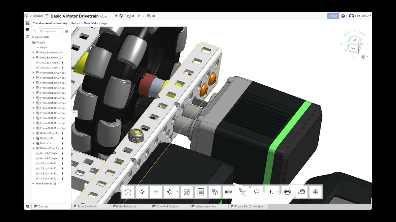

I personally use Onshape, one reason I do is because it is browser based so I can access it anywhere I have internet. Second reason is because they already have a library of V5 parts to use. And third reason is because of how easy it was to learn and how user freindly it is.

here is a great tool for anyone to start using Onshape.
Edit: it doesn’t go over this in the videos but you need to press shift when attaching pieces to metal stock.
