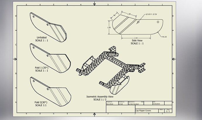

Examples of what you can do with CAD
I want to make a drivetrain, but it seems like every time I do I overlook something with the wheel spacing or motor placement and it messes up my entire plan. So I’ll CAD one in advance!
Now I have an exact model of my drive! I did it all with free software and no physical parts, and now I know I’ll be able to assemble it all according to plan once I start building.
