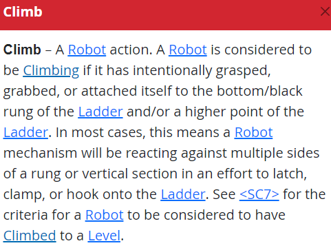

The match has been going strong, and red alliances only hope to win is if they execute on their high hang and high stake. They rush the climbing structure, and begin phase 1 of their climbing procedure. For simplicities sake, lets just say it counts as attempting a hang and nothing specific like a claw, hook, etc.
Blue alliance rushes in, and stops them from actually completing phase 1 of their hang,

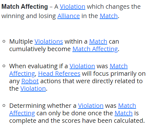

Since the calculation of wether or not a violation is match affecting is based on if the result of the match would have changed if it had not occured, blue argues that red was not going to land the hang, and the points the violation could have affected woule have been 3, for a teir 1 hang.

I did read the manual, here are all the applicable rules I can think of.
Note that this would not preciceley be a major rather than match affecting violation, since this one action would decide the match in its entirety.

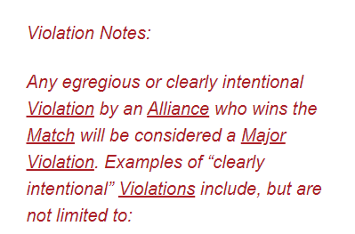

You did not include the red text notes:
As with <G13>, Major Violations are not required to be Match Affecting, at the Head Referee’s
discretion.
Since the climb was low risk and team has demonstrated competent climbs before and blue’s action are egregious with sole intent of preventing climb in progress. I would give red benefit of doubt, DQ Blue as this is a Major Violation and does not need to be match effecting.

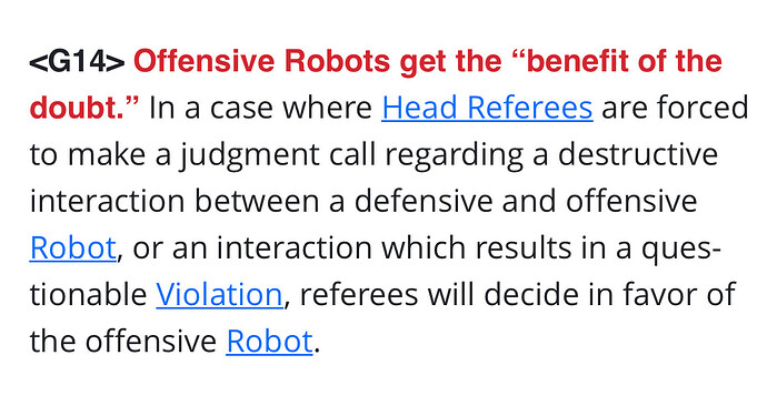

G 14 seems to very clearly answer this question.
Red is clearly playing offense and blue is clearly playing defence therefore the ref should rule in favour of red.
