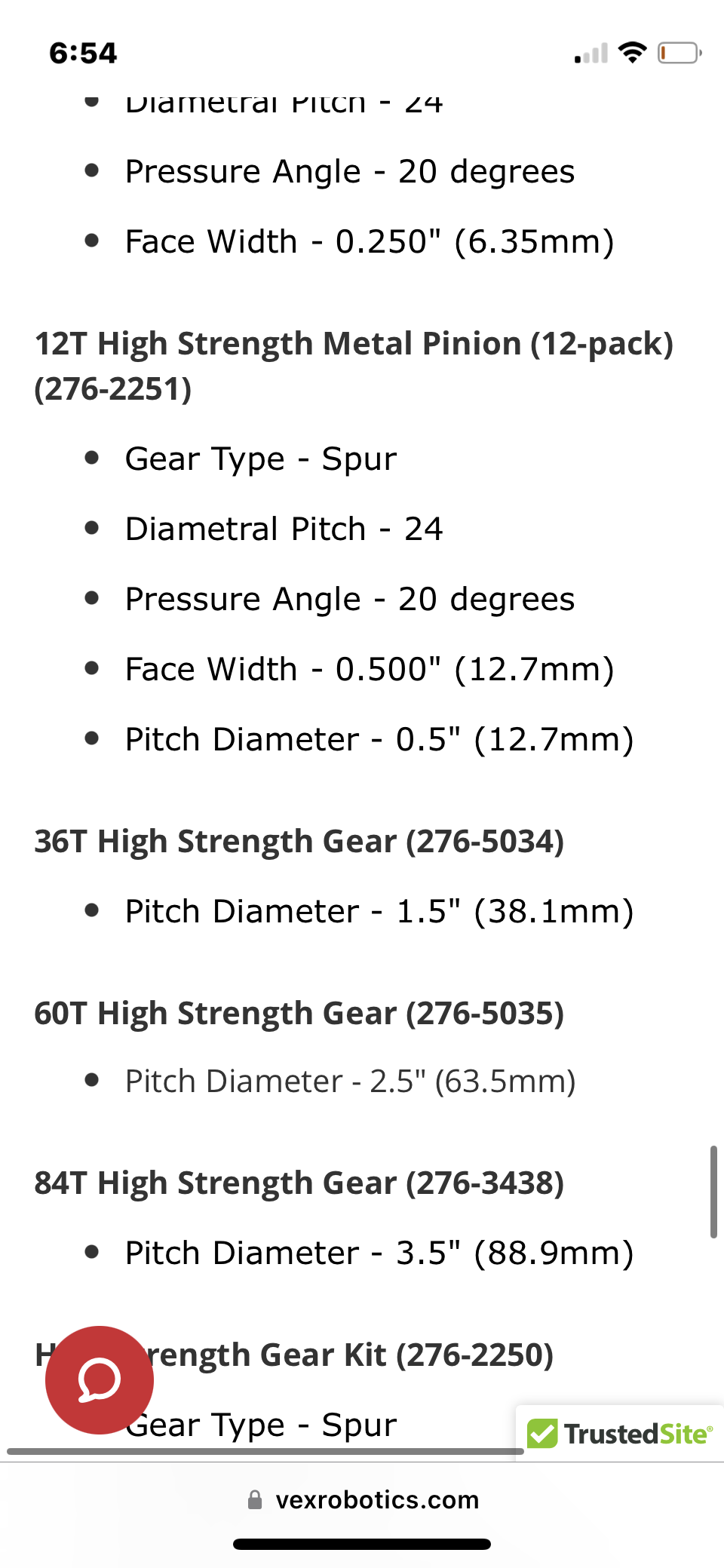

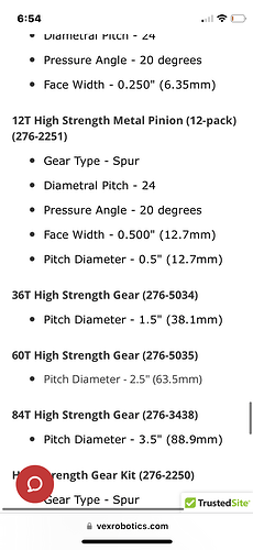

Can anyone tell me the diameters of the 84 and 36 tooth gear
I am trying to fully plan out my team’s bot this year, but I am modeling from home, and don’t have the parts with me. So if anyone could help, would much appreciate it

9motorgang’s solution is solid. Another way to approach is that the gears must match the .5" spacing of structural parts.
For the “old” gears, the 12 tooth is .5" and each size up is +24 tooth and +1 inch. So 12, 36, 60, 84t == .5, 1.5, 2.5, 3.5"
The “new” gears 24, 48, 72t == 1, 2 and 3"
The 72t are 3", the 48t are 2", and the 24t are 1".
