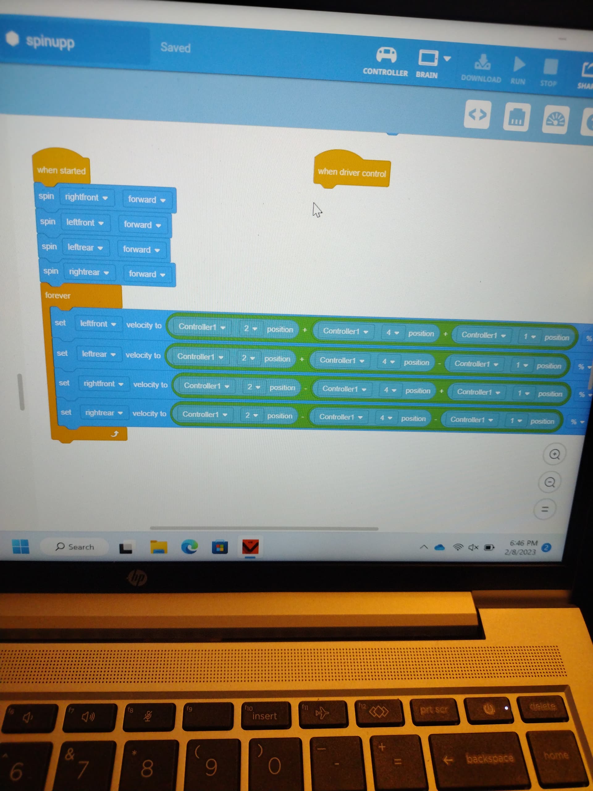

Can someone help im team is new to mecaum wheels and used all the videos to program but my wheels won't move move forward with the controller
Here’s my program
I also redid all my wheels 2 times with new motors
Can someone help please thank you

The set velocity block sets a motor’s velocity for the future. If you set the motor’s velocity to 10 percent, then whenever you spin it, it will try to spin at 10 percent speed.
You want the spin block instead.

First, the code should go in the ‘when driver control’ section, not when started.
Second, save your project under a new name, then change the code to a simple tank drive. See if it works now. If so, your code is good, but your math (the plus minus commands) is wrong. If it still won’t work… start a new project from scratch… this one might have hidden issues.

If you have not already moved them, place all 4 “spin” commands inside the forever loop after the “set” commands.

Also, I see a tiny bit of code in the upper edge of the screen. What is that? Do you have anymore ‘orphaned’ code in the window? That can cause problems also.
The alone blocks are my skills autonomous and my regular autonomous

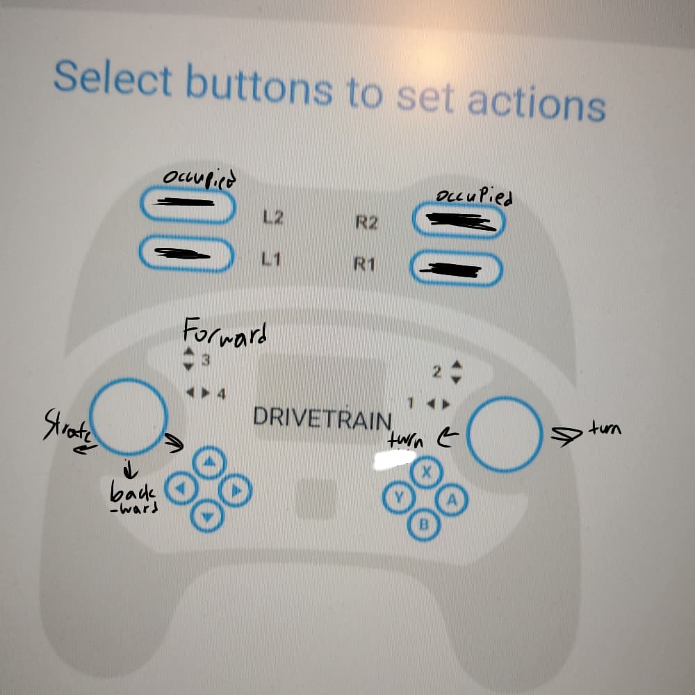

This is what I want my controller to do

First thing I would do would be to to set the left motors to normal and set both right motors to reverse. This will make a positive signal to both sides move the robot forward. most people prefer this. (I normally won’t reverse any motors for a holonomic drivetrain, but lets reverse both right motors in your case.)
A quick search led me to this site with a decent explanation of the basic wheel movements. CS-STEM Network
Here is a pic from that site that shows the force components applied by each wheel when rotating forwards. Read through it so you understand how the forces interact.
1566314670575-mecanum-forward
You want Channel 3 to move forward and from the pic, you can see that a positive to each motor will move the robot forwards. Ch 3 should be positive in all velocity formulas.
To strafe right (positive channel 4), leftfront and rightrear need a + signal, while leftrear and rightfront need a - signal. Channel 4 must have those signs in your velocity formulas
To rotate right (positive channel 1) both left motors need a +signal and both right motors need a -signal

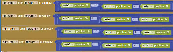

so__________________________ regrouping for block code and consitent structure
leftfront = ch3 + ch4 + ch1 _______ ch3 + (ch4 + ch1)
leftrear = ch3 - ch4 + ch1 ________ ch3 - (ch4 - ch1)
rightfront = ch3 - ch4 - ch1 _______ ch3 - (ch4 + ch1)
rightrear = ch3 + ch4 - ch1 _______ ch3 + (ch4 - ch1)

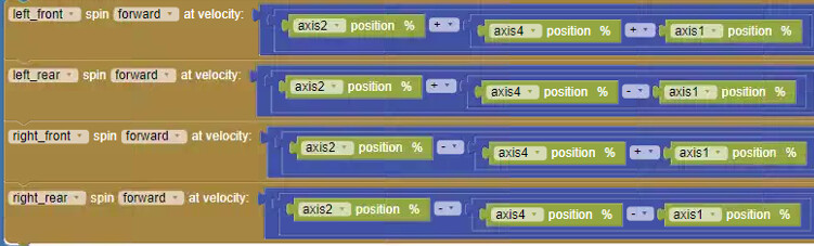

in block code…
Note: I just realized that the last motor in the block code pic needs to be changed to “rightrear”, but you would have caught that.
Hopefully this will straighten things out… remember to reverse only the right motors for this.
